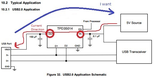

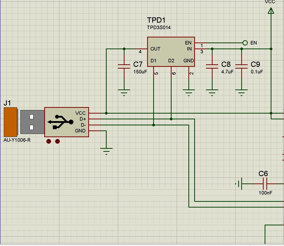

I am beginner at USB interface systems. I am using a TPD3S014 with an USB - UART interface IC.
VBUS is powered by external supply in the application schematic is in datasheet (pins as IN --> 5V Source, OUT --> VBUS). In this case, is the circuit powered by VCC? Does VBUS need an external power to work? What should I do if I want to use both USB bus powered and VCC, does TPD3S014 do this? Just flip the pins?(IN --> VBUS, OUT-->VCC )? Any suggestions? switchable option, another IC or ... ? Also following circuit is correct?
