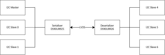

System description:
The Configuration is set as I2C Pass All

My Problem:
The communication with the three slaves where are connected at the Deserializer does work fine. But I coulden't communicate with the slave at the Serializer side.
The SCL signal stays low. When I disconnect the Deserializer side, the SCL signal goes high and I can communicate with the Slaves at the Serializer side.
Why stay the SCL signal low when the Deserializer is connected?
Is there something wrong with my SerDes Configuration?
