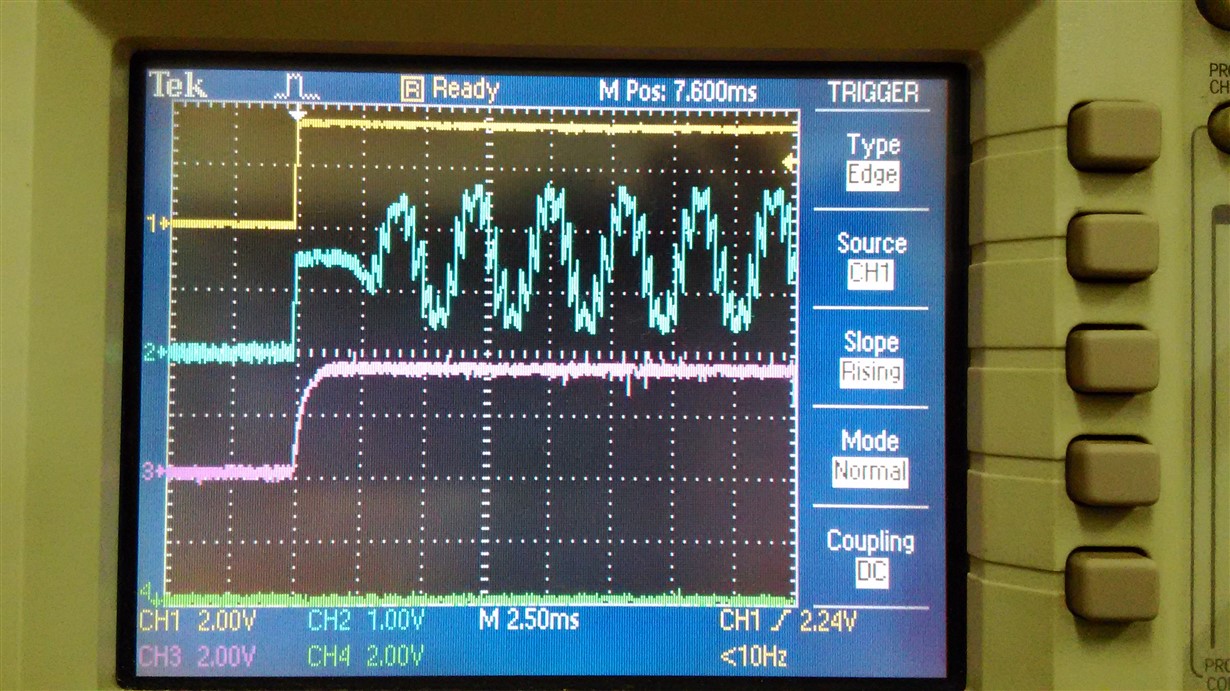

    Below is the timing diagram with DP0 signal (purple):
    The Ch 1 signal (Yellow) is the +3V3 signal.
    The Ch 2 signal (Blue) is the XTAL1 signal
    The Ch 3 signal (Purple) is the DP0 signal.
    The Ch 4 signal (Green) is the Suspend signal
    OVRCUR signal is at is following the 3.3V signal and remains High.
    If you were to look at the signal upon force reset I captured earlier as shown below. Based on the picture, the oscillation cycle period is about 15mS, which worked out to be 1/15mS = 67Hz,  this is not right as the crystal oscillator used in the circuit is 6MHz.
    What could be the mistake? Thanks.
  • The amplitude of the XTAL1 looks low as well.
    I can't see the value of the load capacitors but try reducing them.
    Can you tell what is the lot code of this device? I want to look on the production records, if you are not sure which one is the lot code please post a picture of the top marking of the device.
    Double check your layout on the crystal section, look for short circuits.

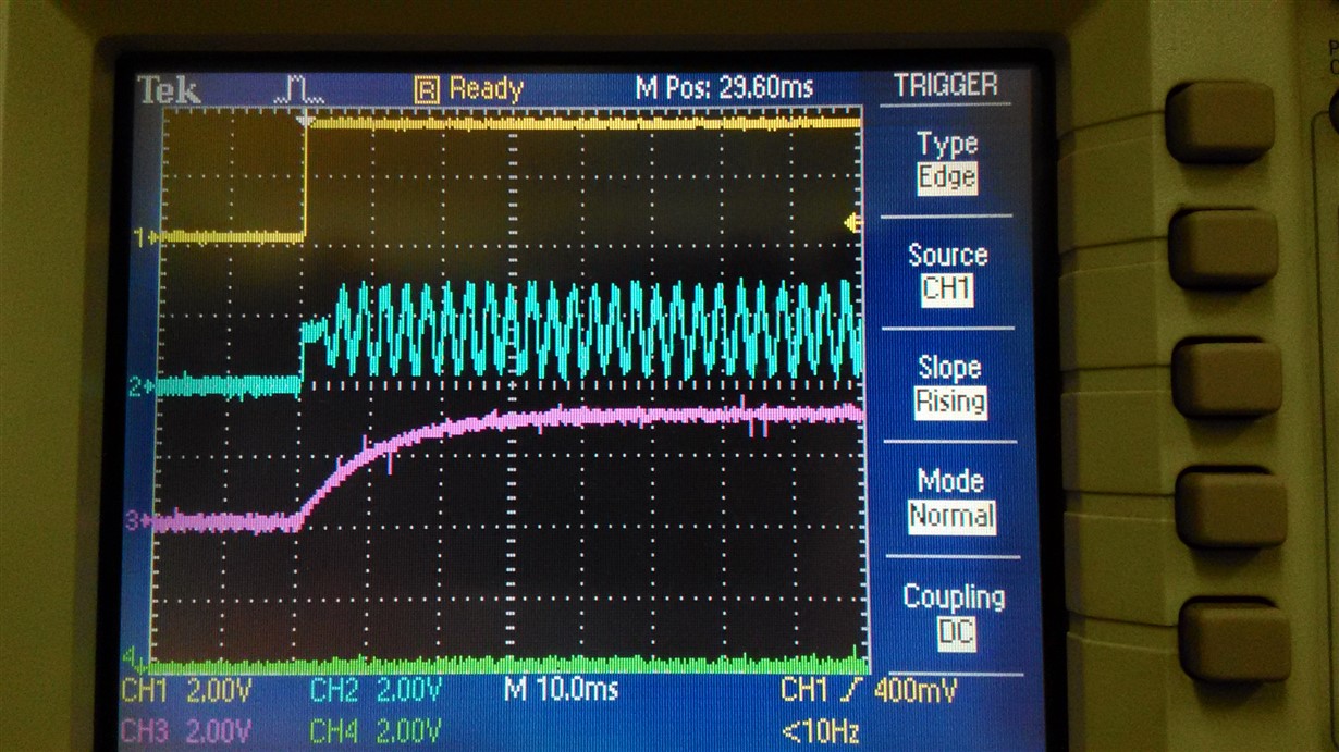

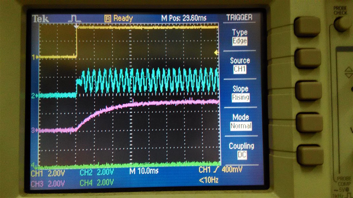

    I remembered reading from the forum that the reset timing is very critical to the USB operation, so I experiment it by replacing the 15K resistor with a 200Kohm trimmer, with capacitor remains at 100nF. Below are the timing diagram from different trimmer settings :
    The Ch 2 signal (Blue) is the XTAL1 signal.
    The Ch 3 signal (Purple) is the Reset signal.
    The Ch 4 signal (Green) is the Suspend signal.
    1st trimmer (lowest resistance) setting:
    2nd trimmer resistance setting:
    3rd trimmer resistance setting:
    4th trimmer resistance setting:
    5th trimmer resistance setting:
    6th trimmer resistance setting:
    7th trimmer (highest resistance) setting:
    Even with the above different trimmer settings, I still could not get my USB hub recognized by by PC, any thing else should I try to correct this TUSB2046B "USB Device Not Recognized" problem?

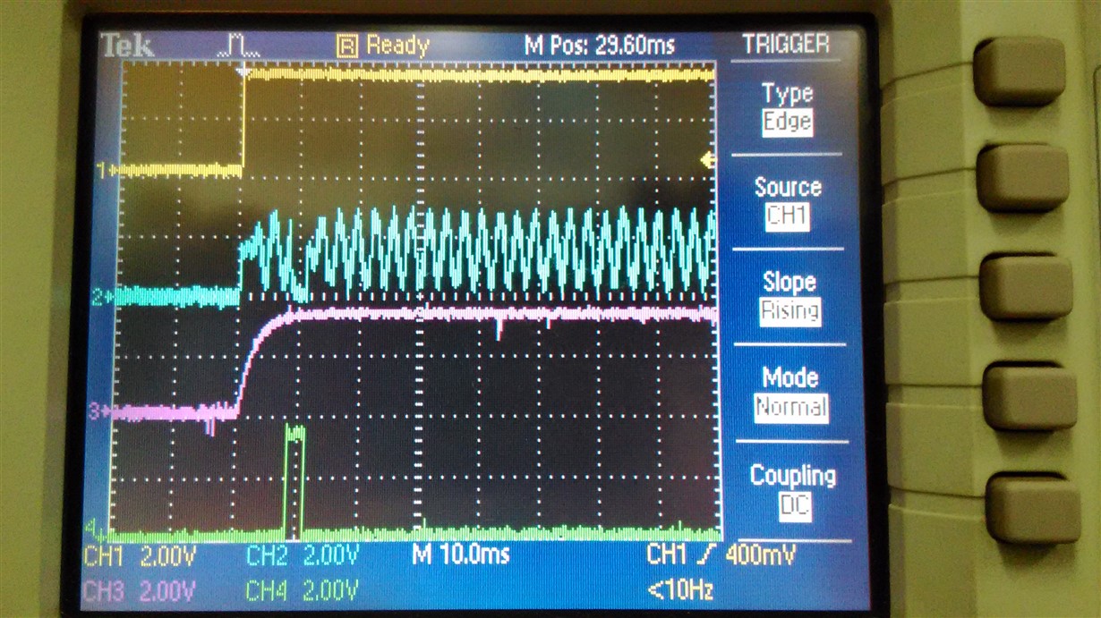

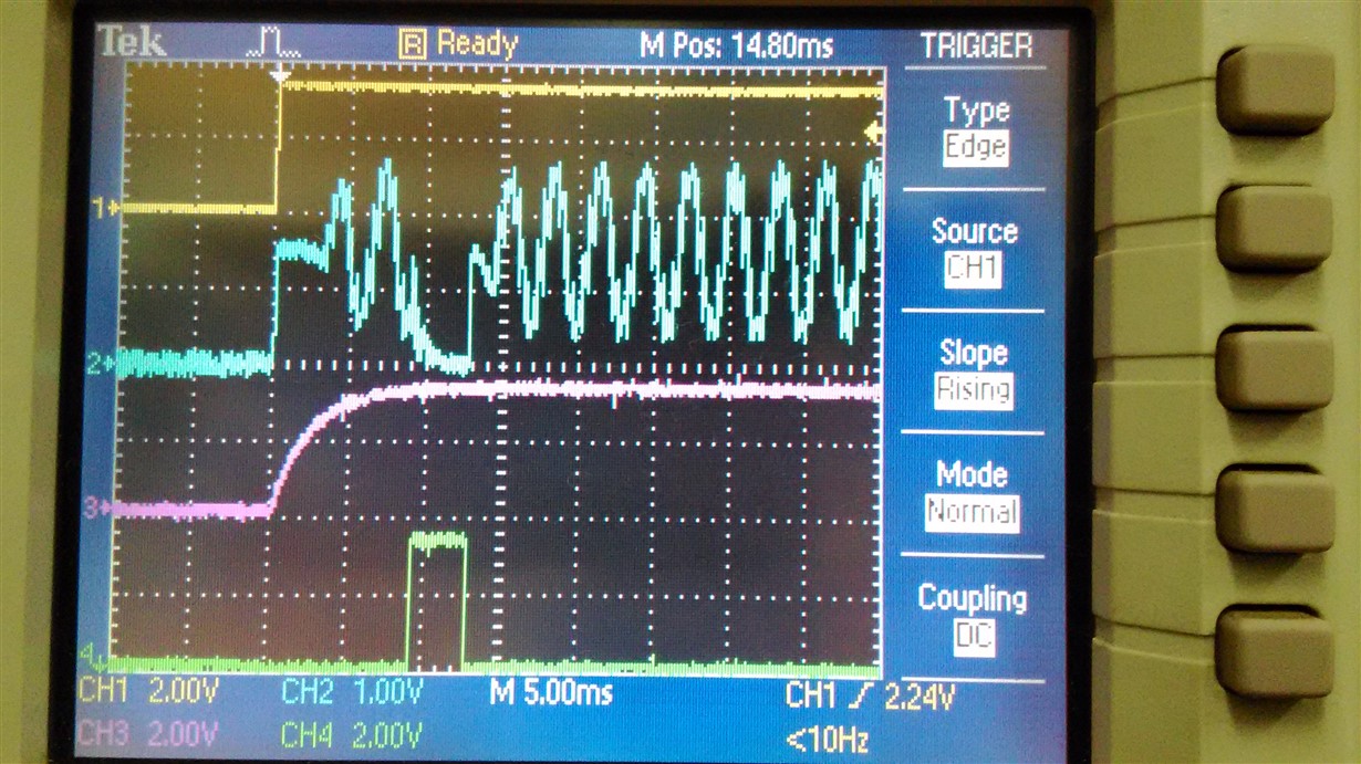

    Texas Instruments recommends a minimum of 100 μs to a maximum of 1 ms of reset timing. By the way, I've monitored that the crystal oscillator is running at 6MHz on oscilloscope. It seems that the reset timing is very critical to the USB operation, so I experiment it by replacing the 15K resistor with a 200Kohm trimmer, with capacitor remains at 100nF. Below are the timing diagram from different trimmer settings :
    1st trimmer (lower resistance) setting:
    1st trimmer (higher resistance) setting:
    Even with the above different trimmer settings, I still could not get my USB hub recognized by by PC. From the above picture, it seems that the crystal only starts oscillate 2.5mS after VCC is applied, this is definitely longer  than recommended reset time of 1mS, If I adjust my trimmer to faster reset rise time, the crystal has not even oscillate yet (Picture 1). On the other hand, if I adjust my trimmer to slower reset rise time, the Suspend line will goes high after 10mS (Picture 2).
    Any thing else should I try to correct this TUSB2046B "USB Device Not Recognized" problem?
    Anyone one with working TUSB2046B USB hub would like to share your experience? Thank you very much.
