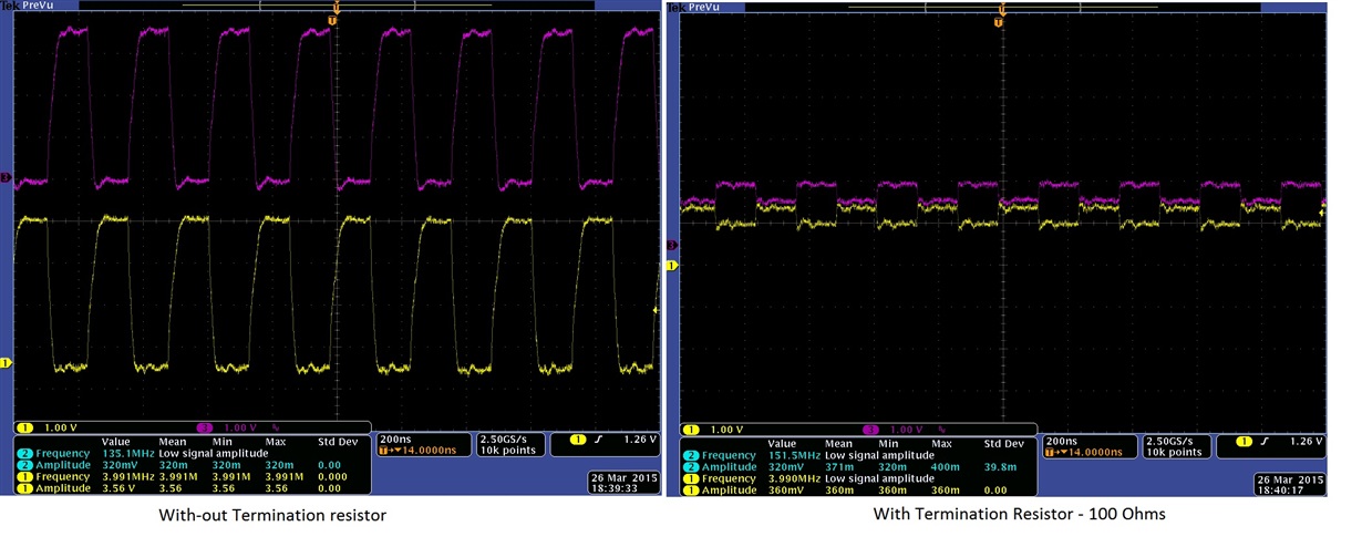

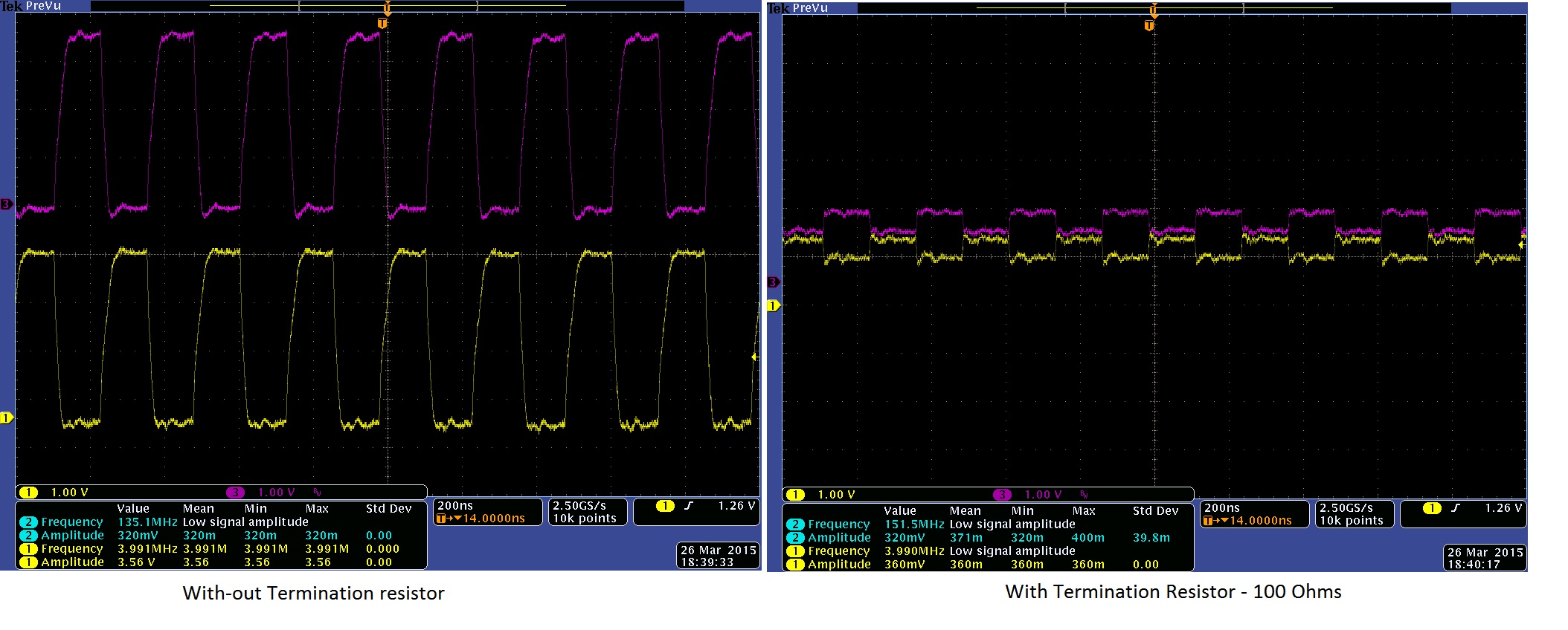

I am using SN65LVDS047 driver & SN65LVDS048 receiver to transmit my SPI signals to a longer distance. During my module testing i have observed the below Issue .
Test Condition: Input signal of frequency 4 MHz is applied to Driver SN65LVDS047 input. Receiver is not connected. Suplly voltage 3.3V, Driver is enabled permanently (Pulled High).
Observation: Both Dout+ and Dout- are giving pulses of 3.3V amplitude (but Inverted). When i terminate with 100 Ohms resistor (Receiver not connected), amplitude decreased to 1.5V. Please see attached wave forms.
Is it a expected behavior ..?? As per my understanding, LVDS drivers are current mode drivers, so should not generate voltage with out termination resistor. Kindly Clarify.
