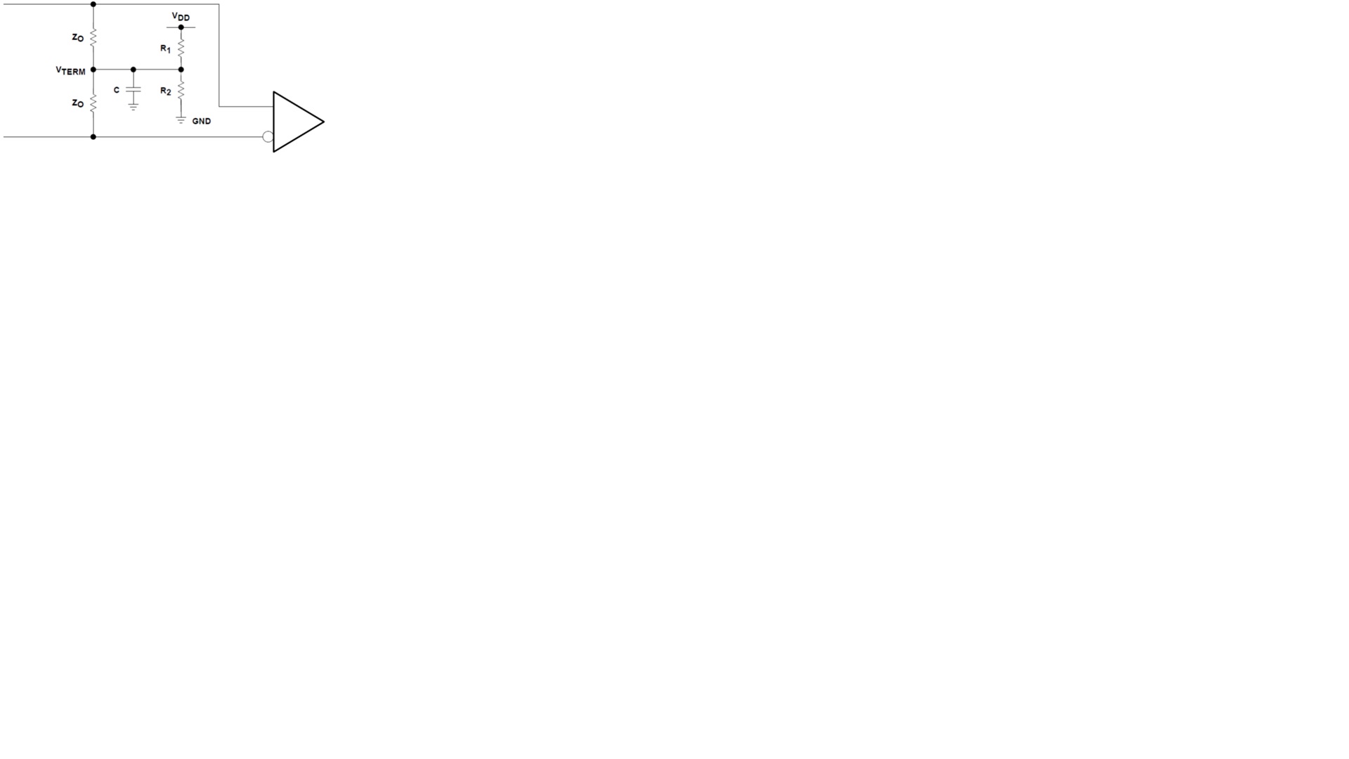

Is it recommended to use an appropriate CM choke in the interface between a TLK2711 driver and receiver to make sure the interface remains balanced and to avoid chassis current? Has anyone used this interface this way? if so, was the filter placed at the driver output or the receiver input? Was the 2711 interface AC or DC coupled? What improvement or issues did you observe?

  • I was wondering whether adding a CM choke will further help to balance the interface even while it is AC-coupled? Has anyone implemented or tested this interface with CM choke?
    3 more questions:
    1. Are there test measurements of chassis/structure current between a TLK2711 driver and receiver a few meters apart and in two different metallic electronic assemblies each being powered with a different power supply (the return of the supplies are tied to metallic structure that connects the two metallic electronic assemblies)?
    2. Figure 12 of TLK2711A datasheet shows the series capacitors at the receiver input, I am assuming there are similar capacitors at the driver output? Is there an app to show what the recommended value of these capacitors should be at various data rates?
    3. This termination scheme inside the TLK2711 receiver with its additional Capacitor to minimize differential skew and common-mode noise was also recommended in one of TI app notes. Is the cap shown below also implemented inside the TLK2711-SP receiver?
