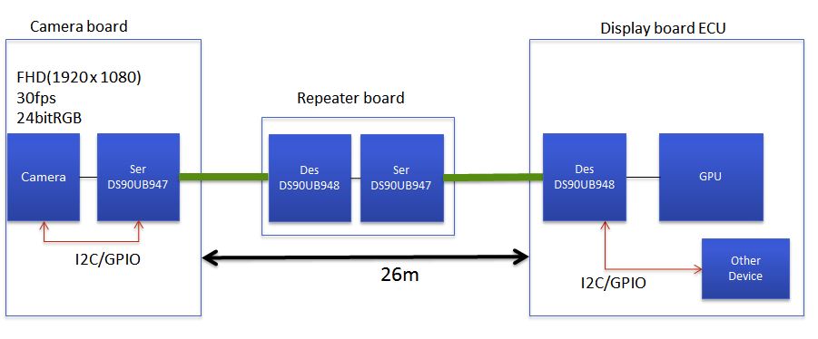

Can we use the DS90UB947/948 on the attached diagram?
The customer would like to communicate the data of FHD(1920x1080, 30fps, 24bit RGB) up to 26m.
Can we use the DS90UB947/8 with camera application?
If there are the other recommendation device and constitution ,please let me know.

    Sorry.
    The information was updated from the customer.
    They considering the device of DS90UB913/4A instead of DS90UB947/8 in the previous picture.
    Can we use DS90UB913/4A with  up to 26m cable with PoC, line rate 1.4Gbps , if we use the repeater board?
