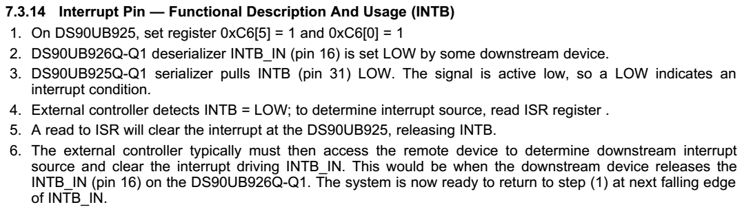

The datasheet describes the way to release the INTB pin by reading ISR(0xC7) register,
however, is it only way to release the INTB?
Other than this, is there any other way possibly cause to release asserted INBT pin?
Thank you for your support.
