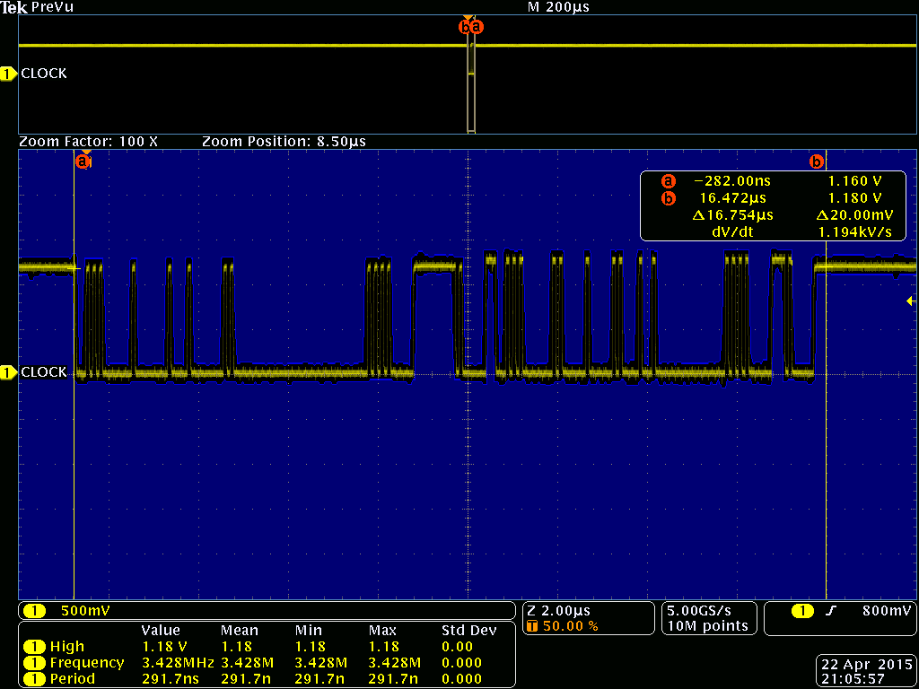

We got SN65DSI86 (-Q1 version for prototyping) on a test board. Did not hookup I2C (as this was intended), and wanted to configure it strictly over DSI channel.
At first, the board was strapped for 27MHz crystal - and watching DSIA_RX0 with a scope gives the following:

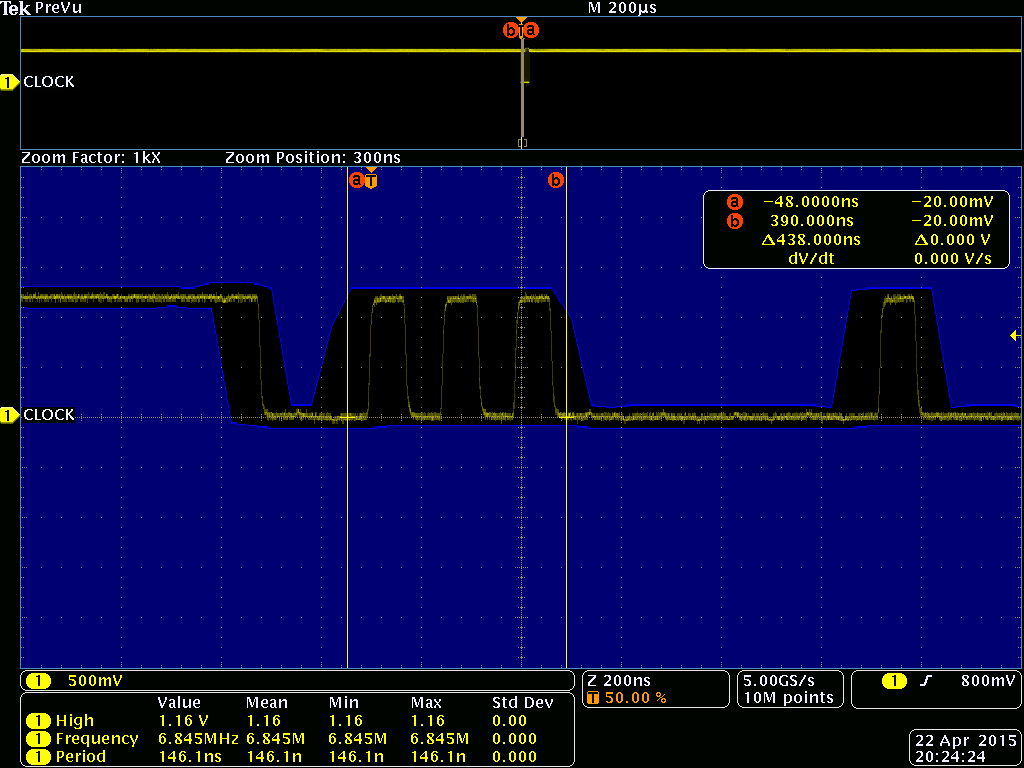

pic1: zoomed into transmission, to see bit time. 146ns.

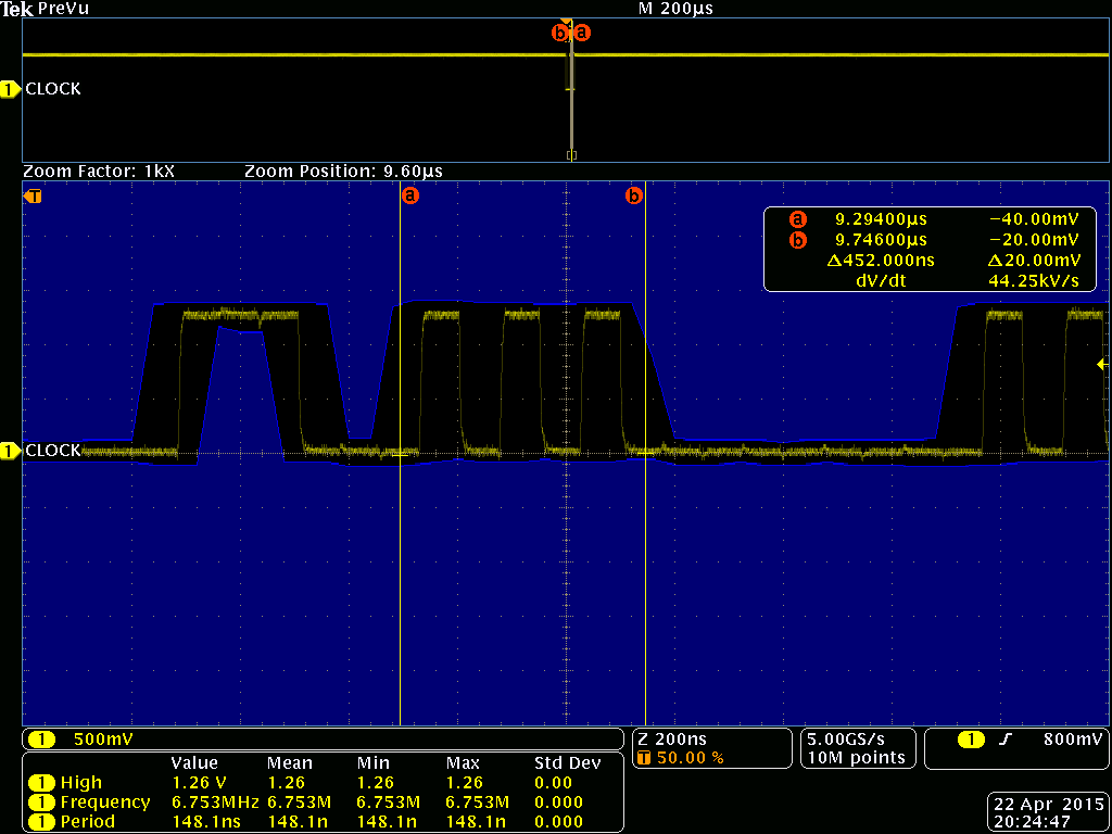

pic2: zoomed into reply from DSI86, to see bit time. 148ns.
However, the DSI host is not seeing reply - It is actually seeing DSI return packet 0x11, I think, but the data fifo returns empty. Below pic is entire exchange.

The transaction looks ok, is 2ns difference in bit width going to  affect reception?
On the DSI host I don't have a lot of granularity for setting transmission timing - there is 'LPTIME' parameter which is currently set to '6' in order to get the 146ns-wide bits. Setting it to 5 gets me 124ns wide bits, and 7 gives me 167ns.
If this 2ns @27MHz timing is not accurate enough, is there something I can blindly write into the DSI86 registers (over DSI) to switch it into clocking from DSIACLK or similar? Or is there something else I'm misisng for the setup.
The Short read (0x24) and its arguments are correct (well, I'm reading register 00, and expecting to get back 0x20).
This is the first command I'm sending to DSI86, after deasserting Enable pin. Communication is in LP mode, using DSIA_RX0.

    The scope screenshots in first post are "LP Data Transmission" as in figure 32 in the PDF you linked.
    Because of slightly different voltage levels between send and receive, I believe DSI86 is replying, and sending different data (i.e. reading addr 0 or 3) returns different bits in reply as tested by the limit mask on scope, so I think the DSI host is just not properly interpreting the reply either due to
    1) not supporting 0x11 short reply
    2) the ~2-3ns timing difference in 27MHz oscillator mode is messing up reply reception.
    What do you think?

  • I don't think that 2ns affects the reception but you can try to use the MIPI DACP/C as clock source by setting the PPLL_CLK_SRC pin high and configuring GPIO[3:1] to value that matches the DACP/N frequency (Refer to Table 1 of device datasheet). Assert EN before performing a write/read request.
    Your scope capture (LP Data Transmission) shows how the data lane enters to escape mode, but the arguments for a Generic Read Request are not clear. Could you point out the read transaction and the DSI86 response IDs?
