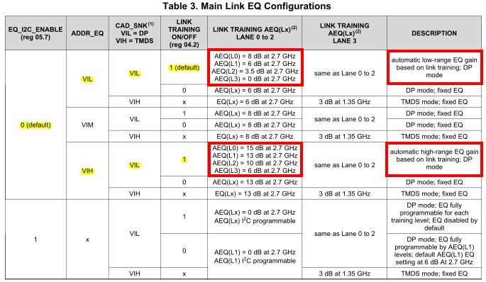

Could you please allow me to ask you about the equalizer function of SN75DP130.
[Question 1]
How does SN75DP130 optimize EQ gain setting through the link training sequence at default setting (automatic low-range EQ gain based on link training: DP mode) ?
I believe the Source and Sink will use AUX signal for link training. My understanding is that link training will only optimize pre-emphasis and VOD, by monitoring the AUX signal.
[Question 2]
In the table below, there are four EQ gain for "automatic xxxx-range EQ gain setting" (CAD_SNK=VIL, Link Training = ON).
What does AEQ "(L0)" / "(L1)" / "(L2)" / "(L3)" mean ? Does this number means that the device first applies higher gain and then sweeps to lower gain to find out the best gain setting out of this four settings ?
I also wonder why it is not the opposite like L0=0dB, L1=3.5dB....

  • Hi Kawai,
    SN75DP130 will choose EQ gain according to pre-emphasis result from link training, as table 3 note (2) states.
    "(L0)" / "(L1)" / "(L2)" / "(L3)" are pre-emphasis levels from link training
    e.g.
    After link training pre-emphasis level is L2, then EQ gain will be 10dB at 2.7GHz

    [Question 3]
    I understood that the SN75DP130 automatic EQ gain setting depends on the pre-emphasis level setting based on link training. When pre-emphasis level is low --> EQ gain would be high, and when pre-emphasis level is high --> EQ gain would be low.
    I have one question here. If the trace length between the Source CPU or FPGA and SN75DP130 is very short (e.g. very low loss), in the case when "(L0)" is selected, the signal would be over equalized and the signal would not be optimized. When do you use automatic EQ selection and what is the best way to optimize the EQ gain ?

  • Hi Kawai-san,
    This is the response we got from design team:
    Thus, EQ gains in datasheet are maximum values
    In case you need different EQ gain, you can use link training to chose PE, then, using I2C you can configure a fixed EQ gain according to PE level and lane number.

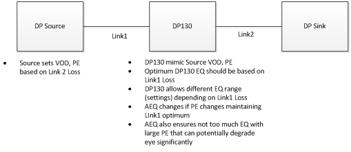

  • Hello Moises-san,
    I apologize for my delay. Thanks for the feedback.
    I have forgotten that, in general, using DP repeater means that there is some trace length (loss) between source device and DP connector (Link1). I agree in this case. EQ and PE were in inverse proportion because the relation should be, EQ gain + PE gain = Link1 loss.
    In my customer case, their source device does not have PE function and only have fixed VOD. It does not have full link training function DP, however, it does have AUX signal to communicate with the sink device. Our customer wants to use DP130 to achieve link training with the sink device. If their were only small loss between source chip and DP130 (trace length 10-20mm), I believe AEQ could potentially over equalize and degrade the eye.

  • Hi Kawai-san,
    Should be no problem, if this application has fixed VOD and no pre-emphasis (Pre-emphasis level 0 and pre-empahsis Post Cursos2 Level 0), AEQ has a maximum gain of 8 dB, AEQ will choose the optimum, which could be any value from 8 dB down to 0 dB.

    Isn't the EQ gain fixed to pre-emphasis(PEM) setting one by one like below ? Maybe I had been misunderstanding.
    If PEM level is L0, EQ gain will be AEQ(L0) = 8dB
    If PEM level is L1, EQ gain will be AEQ(L1) = 6dB
    If PEM level is L2, EQ gain will be AEQ(L2) = 3.5dB
    If PEM level is L3, EQ gain will be AEQ(L3) = 0dB
    Does automatic EQ function scan all AEQ(L0) to AEQ(L3), then selects the best EQ gain setting ?
    Kawai
  • Hi Kawai-san,
    From design team response, EQ gain is not fixed, it is a maximum value.
    e.g.
    If PE is L0, EQ gains could be up to 8dB, but if a lower value is needed it is used.
    There is no scan over PE levels' gain.
  • Hi Moises-san,
    Please let me summarize my recognition for automatic low-range EQ .
    When PE is L0, the best EQ gain is chosen from 8, 6, 3.5, or 0dB.
    When PE is L1, the best EQ gain is chosen from 6, 3.5, or 0dB.
    When PE is L2, the best EQ gain is chosen from 3.5 or 0dB.
    When PE is L3, EQ gain is always 0dB.
    Am I understanding correctly ?

  • Hi Kawai-san,
    Yes this is sensitive information.
    You are right, this answers seems to be conflicting, the first answer I gave was on my previous understanding of the circuit, that is why I had to consult design team, they have clarified AEQ has a maximum gain of 8 dB, AEQ will choose the optimum, which could be any value from 8 dB down to 0 dB.
  • Hello Moises-san,
    I greatly appreciate for your continuous support. I have finally understood the operation for the automatic equalization. Regarding your comment, the device equalization level which is selected would follow below condition.
    When PE is L0, the best EQ gain is selected from 8.0 / 6.0 / 3.5 / 0 dB.
    When PE is L1, the best EQ gain is selected from 6.0 / 3.5 / 0 dB.
    When PE is L2, the best EQ gain is selected from 3.5 / 0 dB.
    When PE is L3, EQ gain is always 0 dB.
    It seems it could be used with automatic equalization function. However, we are asking customer to fix the EQ level to 0dB or low gain as they only have 10-30mm trace between the source device and the DP130. We will ask customer for enough evaluation.
