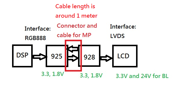

                We have some question as below. Thank you.
1.      Is below plot ok for workable?
2.      Could you kindly provide what kind of connector and cable between 925 and 928 you suggest ?

    The DS90UB925 is from the same family as the DS90UB928, and the two will operate will together as you have shown.
    The cable should be a shielded twisted pair cable, with a 100Ohm differential impedance. A common connector used in the automotive market for this application is the Rosenberger 'HSD' cable, which carries two twisted pairs - the second pair could either be left open, or could be used to carry power to the display.
