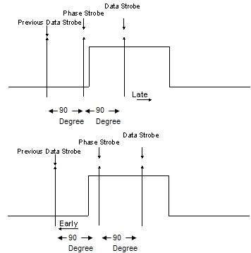

  • Hi David,
    TLK devices use a 2x oversampled CDR to dynamically adjust the sampling phase in order to track the phase of the input data stream. This clock recovery technique samples the received serial data both during the data periods (center of the eye diagram) and during the transitions. It then determines whether the current sampling point needs to be moved earlier or later by comparing the value of the transition sample to the two adjacent data samples:
    If a transition occurs and the phase sample matches the previous data sample, then the current sampling point needs to be moved later. If the phase sample matches the next data sample, then the current sampling point needs to be moved earlier. These “early/late” decisions are accumulated, and once a certain threshold is reached the update will take effect. The sampling point is adjusted by changing the clock phase that is output from the phase interpolator. Typical distances between phase steps are 1/48 or 1/64 of a bit period (unit interval).

  • Hi David,
    Q1. What is the number of transition bits required to generate an early/late decision for TLK2711?
    A1: The cdr looks at 8ui every 32ui which equates to 8 votes (early/late/neither).  If there is a majority the phase is updated. This answers question 2 as well.
    Q2. What is the number of early/late votes needed for a phase update on TLK2711?
    A2: Refer to Q1.
    Q3. For TLK2711, is the magnitude of phase step 1/48 or 1/64 UI?
    A3: 1/64
    Q4. Is the TLK2711 receiver clock recovery a first order PLL or second order PLL?
    A4: First order
    Q5. Should I model it as Jitter Transfer Function (JTF) or Observed Jitter Transfer Functions (OJTF)?
    A5: Not sure what the difference is.
    Q6. What is the loop bandwidth for either JTF or OJTF?
    A6: We never actually measured it but it is effectively set by the fact that we only mode 1/64 UI every 32UI.
    Q7. If it is a second order PLL, what is the peaking or damping factor?
    A7: Not second order.
