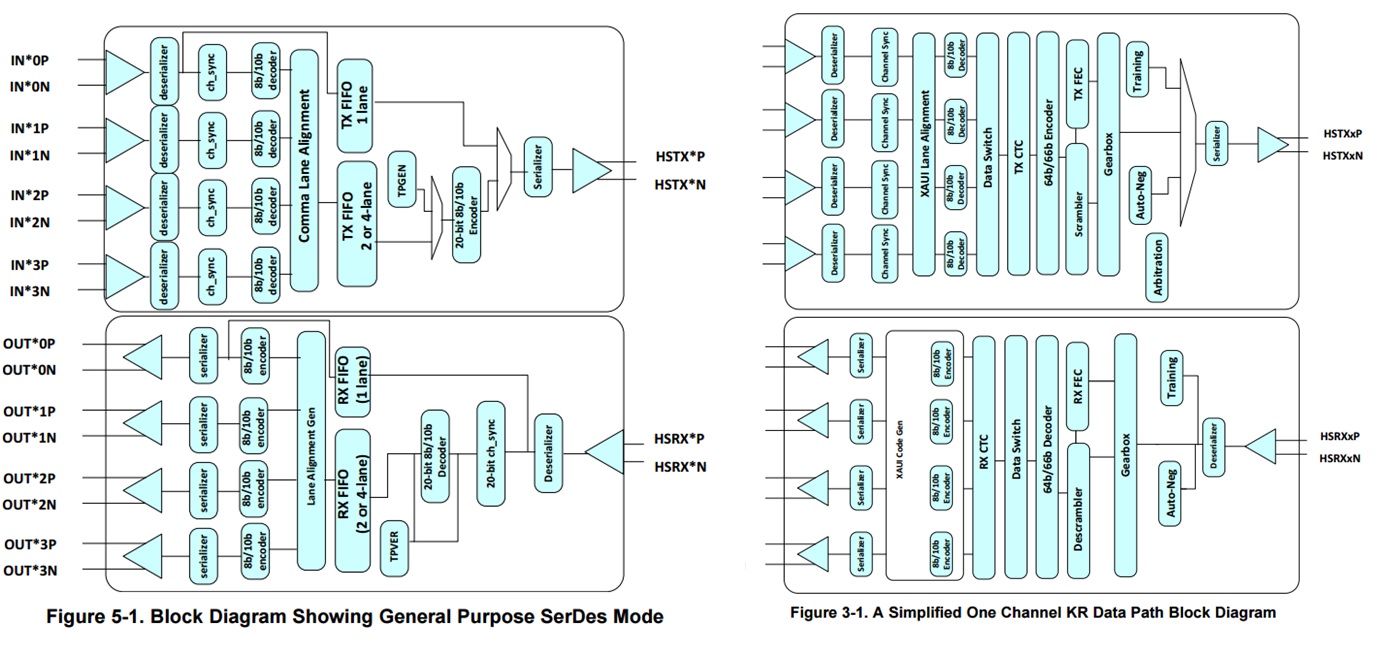

    There are several differences between 10G General Purpose & 10GBASE-KR, below you can see the block diagram of both modes:
    10GBASE-KR mode TLK10232 has built XAUI Lane Alignment, hence, if your application is:
    FPGA(XAUI) ==> TLK10232(LS Channel:4 lanes ) ==>TLK10232(HS) ==>[Fiber Loopback] TLK10232(HS) ==>TLK10232(LS Channel:4 lanes) ==>FPGA(XAUI_10G)  [FPGA is the sender,and also is the receiver]
    Could you clarify me why are you using the General Purpose mode instead 10GBASE-KR?
    Because, in the 10GBASE-KR mode, the TLK10232 performs serialization of the 8B/10B encoded XAUI data stream presented on its low speed (LS) side data inputs. The serialized 8B/10B encoded data is presented on the high speed (HS) side outputs in 64B/66B encoding format. Likewise, the TLK10232 performs deserialization of 64B/66B encoded data streams presented on its high speed side data inputs. The deserialized 64B/66B data is presented in XAUI 8B/10B format on the low speed side outputs. Link Training is supported in this mode as well as Forward Error Correction (FEC) for extended length applications.
    On the other hand in the General Purpose SERDES mode, the TLK10232 performs 2:1 and 4:1 serialization of the 8B/10B encoded data streams presented on its low speed (LS) side data inputs. The serialized 8B/10B encoded data is presented on the high speed (HS) side outputs. Likewise, the TLK10232 performs 1:2 and 1:4 deserialization of 8B/10B encoded data streams presented on its high speed side data inputs. The deserialized 8B/10B encoded data is presented on the low speed side outputs. Depending on the serialization/deserialization ratio, the low speed side data rate can range from 0.5 Gbps to 5 Gbps and the high speed side data rate can range from 1 Gbps to 10 Gbps. 1:1 retime mode is also supported but limited to 1 Gbps to 5 Gbps rates.
