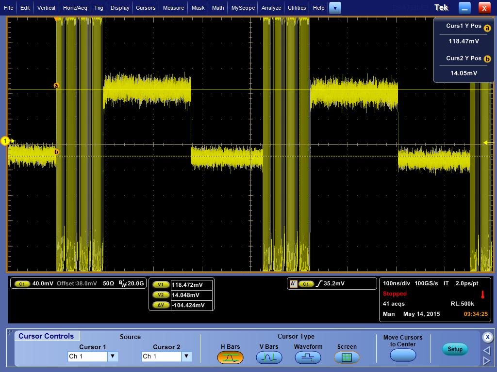

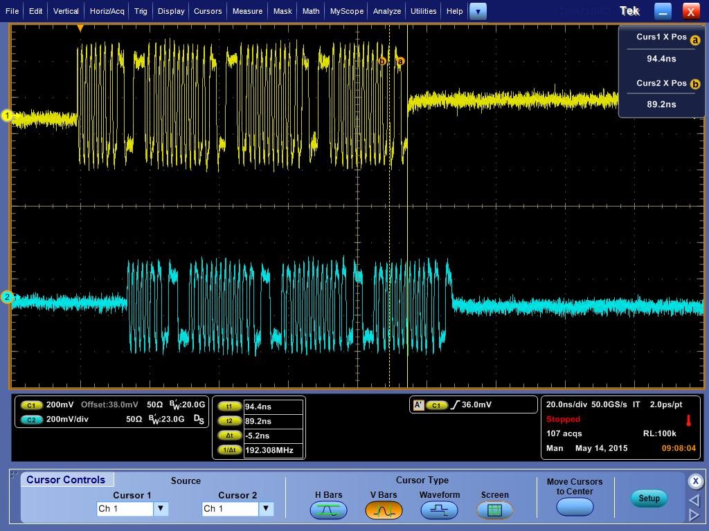

           Our customer use DS125BR410A for active cable application. They connect SAS controller by this active cable with DS125BR401A then connect to SAS expander. They find out a issue of OOB signal on expander side. The OOB looks can not communicate by this topology. Below is signal waveform on expander side.
           Do we have any suggestion for this issue? Thank you.
