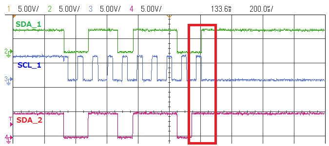

My customer is evaluating TMDS442 and implemented DDC(I2C) as the following.
If "read command"  is issued from Master SDA could be transfered to Slave, however ACK bit from Slave disappeared through TMDS442.
The waveform is the following.
What could I do for this issue?
Could I have your comment?
Yaita / Japan disty
  • Hi Kensuke,
    Signal SDA_1 has not the expected level in ACK bit.
    As yo can see in Figure 38 from datasheet: ACK bit low level (driven by slave) should be lower than the low level when Master has control of the bus.
