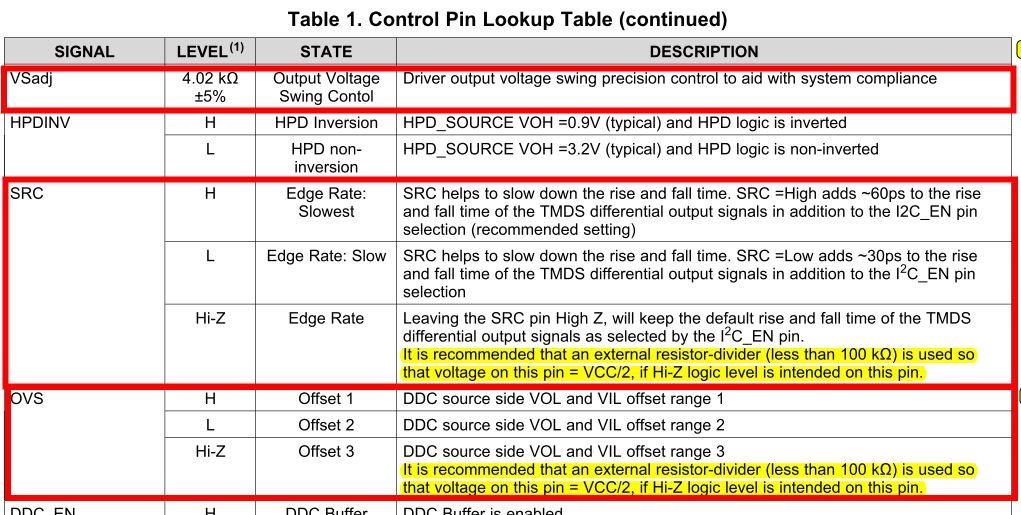

Could you please allow me to ask you about SN75DP139 control pin ?
I see the table below in the datasheet.
[Q1]
VSadj pin : Do you connect the resistor between VSadj to GND ?
[Q2]
SRC pin : When you want to float the pins the datasheet recommends to add resistor divider to this pin. Is it not recommended to keep it floating ?
[Q3]
OVS pin : When you want to float the pins the datasheet recommends to add resistor divider to this pin. Is it not recommended to keep it floating ?
Thanks in advance.
