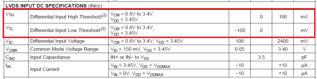

Could you please tell us whether DS90LV804 is able to use for the subLVDS application although Vth and Vtl are +100mV/-100mV as below ?
For the subLVDS application, DS90LV804 should receive the input signal of 100mV@Vid.
Do you recommend to use it for the subLVDS application ?
