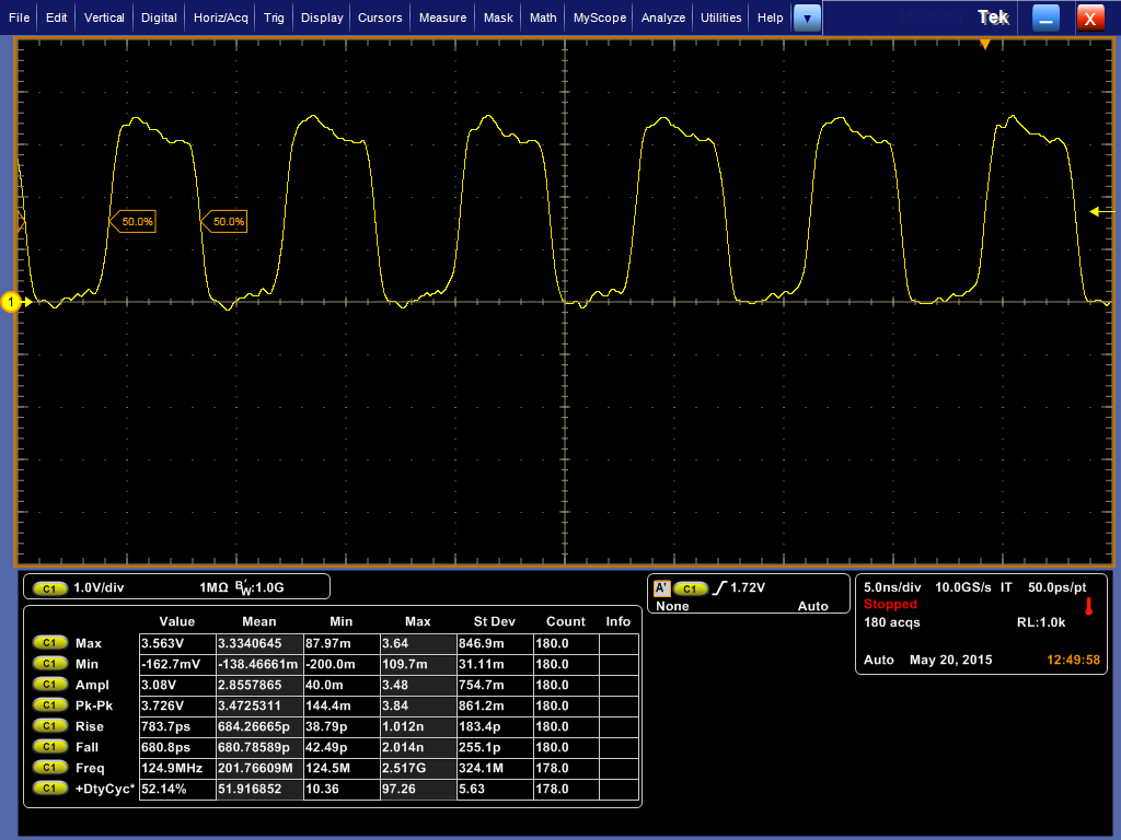

Below value is measured with Vid=±100mV, but the input of SN65LVDS105 is LVTTL level, it should be in Via, not Vid.
My input is Via magnitude is over 3V as below shows.
The differential output magnitude is as blow with 100 ohm load. The |Vod| peak to peak value is much larger than stated max value 454mV. I measured it with a 50 ohm differential probe. Is this a normal operation for the output magnitude? Thanks.
