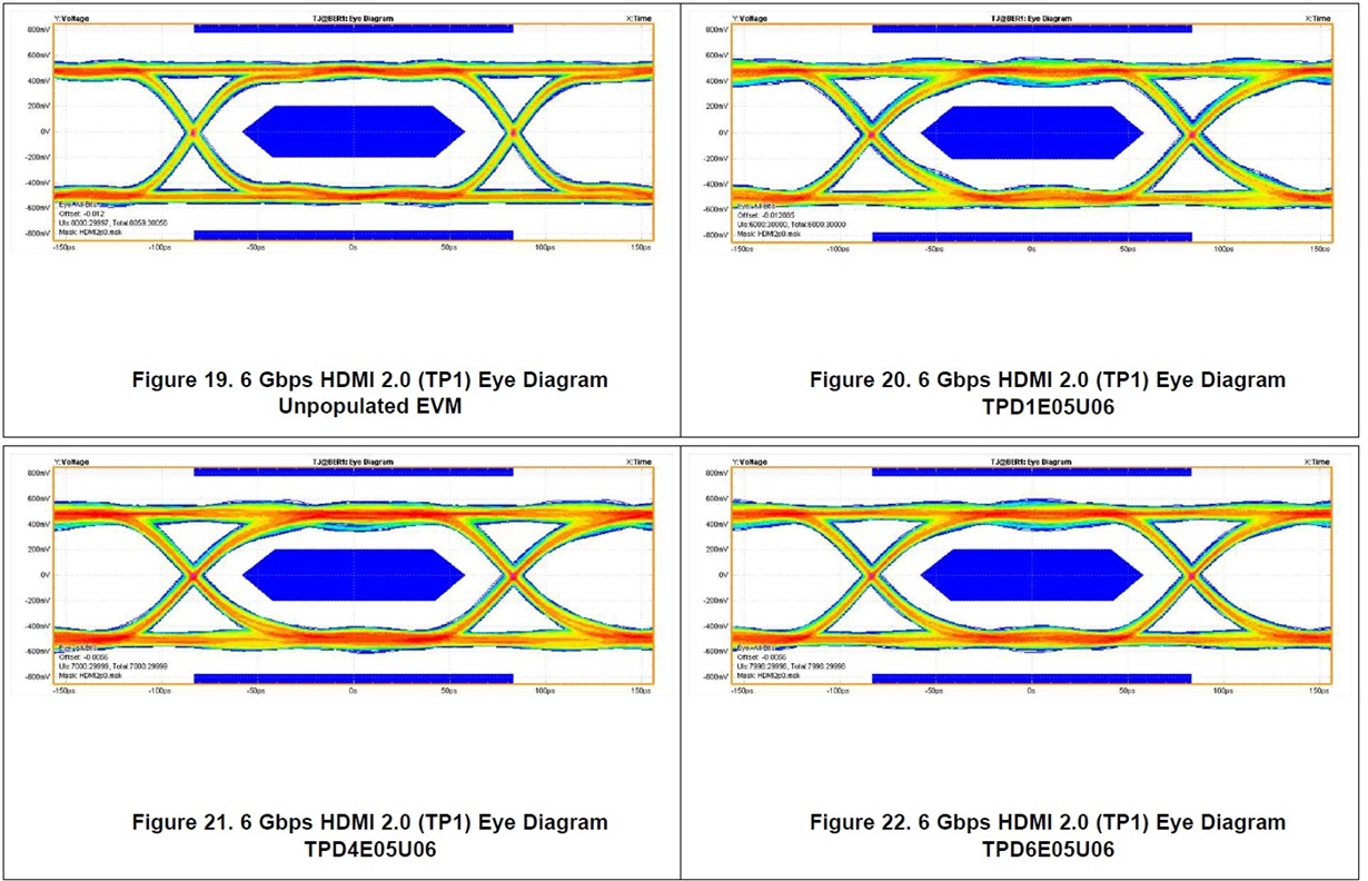

Hi Todd,
Yes, TPD4E05U06 and TPD6E05U06 support the HDMI 2.0 data rate of 6 Gbps. From the TPDxE05U06 data sheet, we can see all devices in that product family are capable of supporting that data rate:
