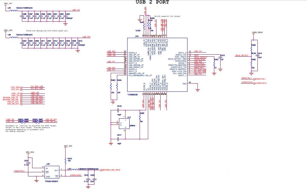

Please help to review the Schematic for 2 Port USB based on TUSB8020B for the Project: In Vechicle Infotainment system.
