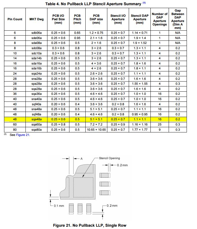

  • Hi Ogane-san,
    1. For information about designing the thermal pad for this package, please refer to SNOA401. Page 19 should be useful to explain soldering for the thermal pad. Typically solder is placed with a solder stencil in the middle of each square aperture section of the thermal pad, and a thermal via is placed on the intersections of the apertures.This helps improve board assembly yields.
    2. You can connect all the VSS GND pins to the thermal pad with a through via.
    Michael

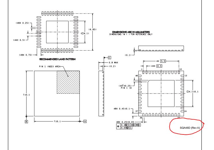

  • Hi Micheal san
    Thank you for your reply.
    DS99R105 is 48WQFN(SQ48 ), but this device is not described in the SNOA401.
    Please give me the following thermal via information.
    If you don't have the information, please tell me the number of via, thermal via pitch and via size.
    I would like to receive your advise as soon as possible.
    Sho Ogane

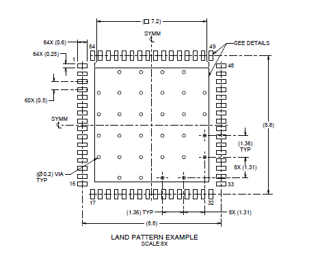

  • Hi Ogane-san,
    I looked closer at the DS99R105 and noticed that, assuming you are using the WQFN48 package and not the QFP package, the SNOA401 document should still be relevant. On the mechanical drawing at the end of the DS99R105 datasheet, there is a notice indicating that the item is SQA48D:
    Referencing the SNOA401 document, on p.6, this drawing matches the No PullBack (QUAD) for 48 pins, identical to SQA48A. Therefore, you can see stencil information in the following table. It looks like the ideal number of DAP aperture openings for thermal vias is 16.
    Recommendations for thermal via diameter and pitch for a typical No-Pullback package on PCB is provided on p. 10.
    Michael

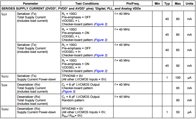

  • Hi Micheal san.
    Thank you for a lot of advice for me.
    I recommend this device to my customer, but my customer have negative point about the quiescent current.
    This device's quiescent current is 100mA. My customer is considering TI device or BU17101AKV-M/BU17102AKV-M(Rohm)
    Rohm device's quiescent current is lower than TI device.
    I think my customer will chose Rohm device, so if you know how to reduce quiescent current,please tell me  it.
    The value that my customer expects is about 50mA.
    Sho Ogane

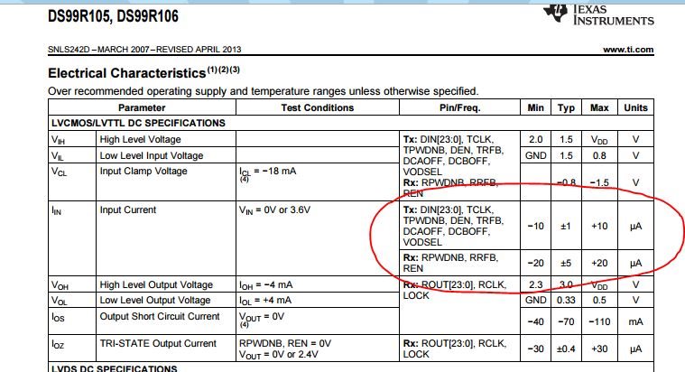

  • Hi Ogane-san,
    Thanks for the feedback. How is your customer determining the quiescent current? From the datasheet, I am seeing that the current should be somewhere around 10-20 uA, not 100 mA. It is possible that I may be misunderstanding what the customer is trying to do.
    It is possible to minimize the quiescent current to 0 A from a systems standpoint by removing connection from the power supply regulator to the VIN pin of the DS99R105, DS99R106.
    Michael
  • Hi Micheal san
    Thank you for the reply.
    Sorry, my customer has negative point about Tx and Rx total supply current.
    I think this value is important.
    Please give me your advise.
    Sho Ogane
