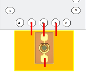

    Like to run by you again, in the event that 8051T has to be used, would below be the best way to lower the chance of oscillation?
    Of course, all wire would need to be same length and as short as possible, is that correct?
  • Ivan,
    This bonding may help but there is still a high chance for oscillation. If for some reason they want to use the ONET8501T then they should consider the ONET8531T instead. The ONET8531T is the exact same part as the ONET8501T except the transimpedace is lower.
    The ONET8551T is a different TIA design compared to the ONET8501T/8531T although it is similar.
