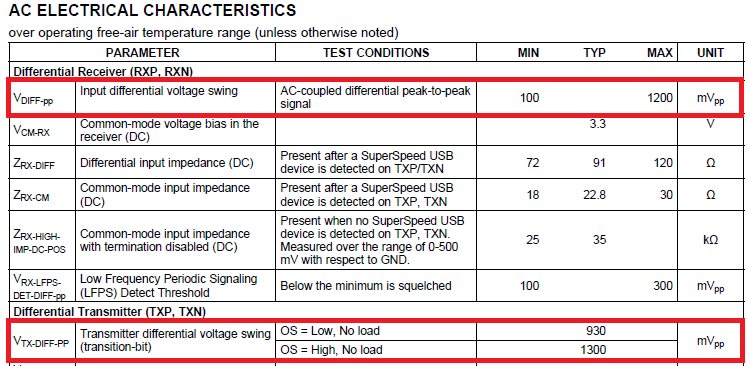

The datasheet shows output swing amplitude is 930mVpp(TYP) when OS=Low.
Does it mean TUSB501 output 930mVpp(TYP) when input differential voltage is 100mV~1200mVpp?
2)
My customer saw the following eye diagram at TUSB501 input (RXP, RXN) but it seems output swing amplitude of TUSB501 is lower than 930mVpp.
Is there any concern about the issue?

    I need to validate the information on the datasheet, so I can provide a feedback regarding the inconsistency. Regarding the eye diagram; the output is quite lower. I would like to see the input eye diagram, as well as the configuration on the TUSB501, also please verify that VCC is within the recommended operating conditions.

    Regarding the question 1: The TUSB501 recovers the input and re-transmits according the configured output configuration, so it is possible to have the case that you mentioned in a first instance.
    I would like to see the layout design, seems that the customer has a lot of loss in a relatively short trace. Typically I would suggest the an EQ=3 or 6, but in this case the loss is higher than the expected. Please provide the layout files to diego.cortes@ti.com, so I can review the design.
    Could you tell me the input condition to output 930mVpp(OS=Low)?
    Does the following indicate that output differential voltage(the transition bit) shows 930mV under any amplitude of input differential voltage swing?
    Yaita
  • Hello Yaita-san,
    The amplitude should be > 100mv, however the input signal that you posted has a lot of skew, as you can see the eye diagram looks kind of twisted. That's why I would like to review the layout. The differential pairs may be mismatched.
