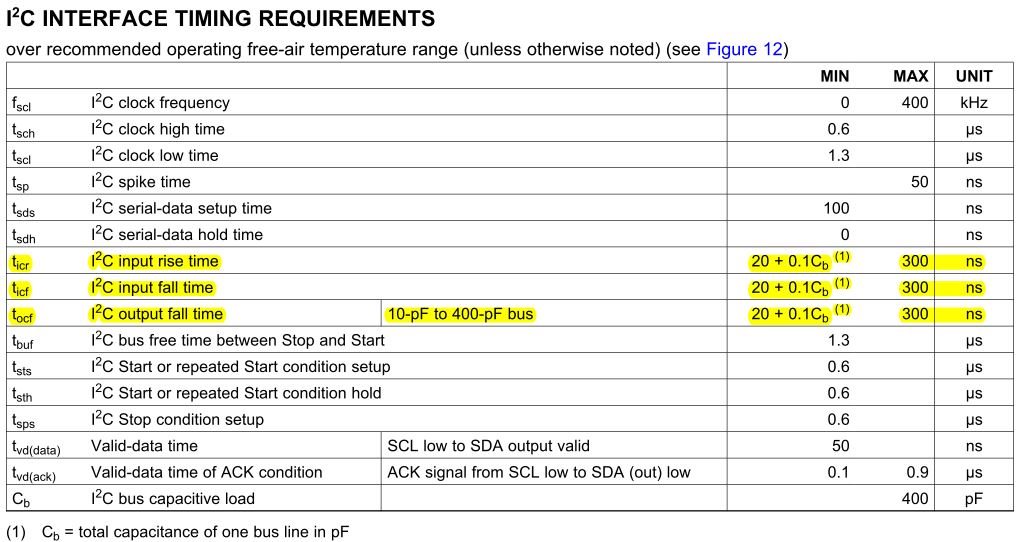

Please allow me to ask you about the switching characteristic spec for TCA9535. For input rise/fall time, TCA9535 datasheet spec is specified based on Fast mode.

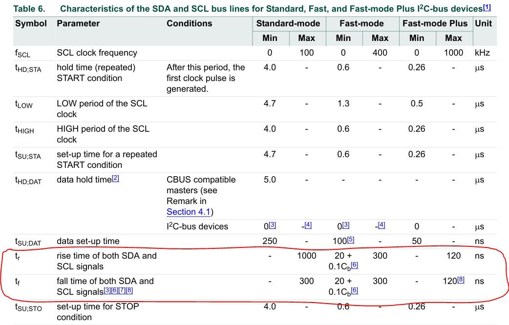

In the I2C specification, Standard mode rise/fall time does not have minimum value specification.
[Q1]
Does this mean that rise/fall time can be lower than 20ns at Standard mode, for I2C specification ?

How about the requirement for TCA9535 I2C standard mode ? Does rise/fall time must be larger than 20+0.1Cb ?
