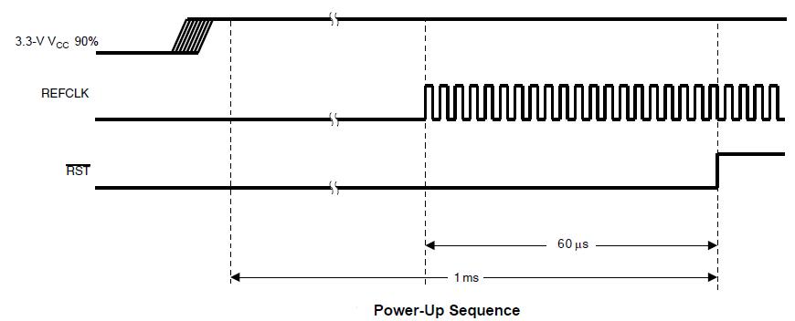

I am using TUSB2046BIRHBRQ1 USB hub in one of our designs. But this hub is not getting detected. I have checked the interface which is coming as input to this hub and it is working. I have verified inputs like 3.3V VCC pins, Hub control signal and crystal of 6MHz frequency. Everything is fine . But still hub is not detecting any of the ports.
Please anybody help me in this regard.
