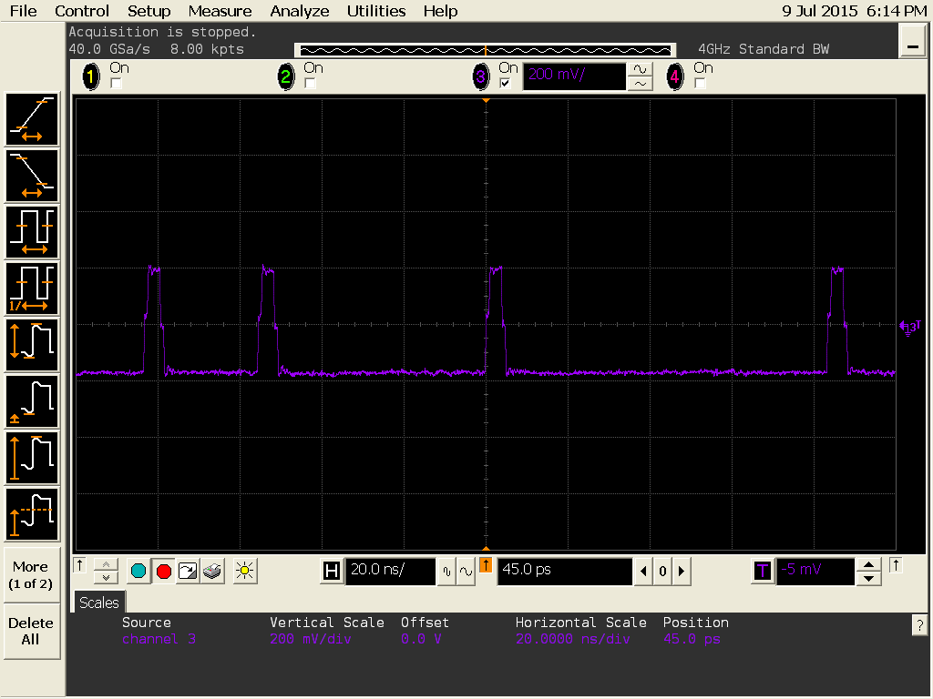

Customer found something abnormal, below is LVDS spec. of 928, the Vodp-p should be 900mV, it only meet the spec. when no resistor on the P and N signal trace, you can see the plots as below. When mount 100 ohms between P and N, the Vodp-p will drop to 400 mV, there is no LCD panel on the above test. Could you help to double check the design of 925 and 928 and provide comments? Thank you.
