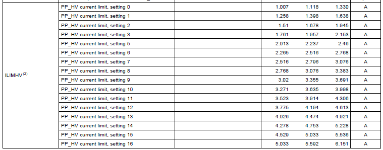

My customer is evaluating TPS65982EVM and wants to change the value of PP_HV current limit.
Could you tell me how to change the value?
I believe it could be changed by updating application code.
Is it possible by using Aardvark SPI programmer?(User's guide page.28)
http://www.tij.co.jp/jp/lit/ug/slvuaf8a/slvuaf8a.pdf
If the answer is yes, where could I get Flash Center GUI?
