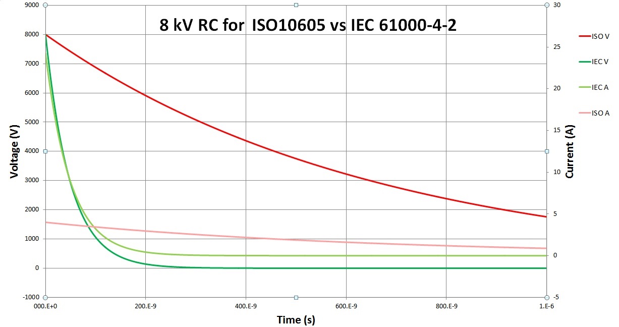

I would like to confirm the specification of TPD4E001-Q1.
It has the specification exceed IEC61000-4-2.
I have a question.
Does TPD4E001-Q1 meet ISO10605 with 330pF and 2kohm?
I think the peak current is small but the energy is bigger than IEC610004-2.
So, I don't know wheter it meets or not.
