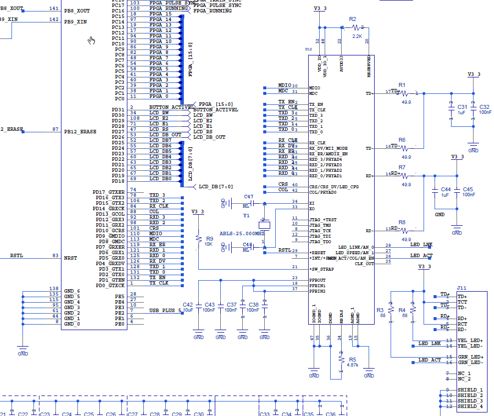

I have a board with the TLK110 wired as per the attached schematic.  (The circuit on the left is an ATMEL ATSAM4E)  J11 contains magnetics as well as the connector.
The problem is that it does not negotiate or establish a link. when a cable is connected from J11 to either the Ethernet connector on my PC or a router.   Some other observations:
1. None of the LED's on the connector/ magnetics go on
2. There is 3.3 V on pin 48.  It's power-on rise-time is ~ 2ms
3. There is 1.5 V on PFBOUT
4. There is 25 MHz oscillations on X1 and clock out
5. The RESET pin is connected to a normally open switch to ground.  It sits at 3.3 V until the button is depressed when it goes to ground and then returns to 3.3V if the button is released.  Doing this doesn't seem to effect the TL!K!10.  It's as if it is continually in reset.
6 On the off-chance that the chip was defective or damaged, I replaced it and nothing changed.
  • Hi Seth,
    Your schematic looks ok but I have a few questions.  Is R5 a 1% resistor?  What voltage do you see at pin 24?
    I see a large bank of caps just outside of the shot.  Are these decoupling for the supply pins?
    Could you give me a dump of your registers during operation to get a better idea of what is happening with your PHY?

    Yes, these are decoupling caps for the TLK110 and other. There are 4 caps (10 uf, 10 nf, 1nf, and 100 pf) for each of the 3 power pins 22, 32,48. On second look, perhaps they could be closer to the respective pins, but I don't think this is my issue right now.

    I don't know what you mean by the "load caps" on the schematic saying NL. The only NL caps that I see are C47 and C49 around the crystal and they are, in fact, not loaded, but the oscillator is clicking along.
    I have noticed something not quite right. R3 and R4, the pull-up for the LED's, are 68 ohms. This means that current through the LEDs and into the TLK pins 25 and 28 will be 16 ma. This is more than the specified 4 ma output drive of the TLK. So I am not totally relying on the LED's to tell me what is happening. But do you think this could screw everything up?

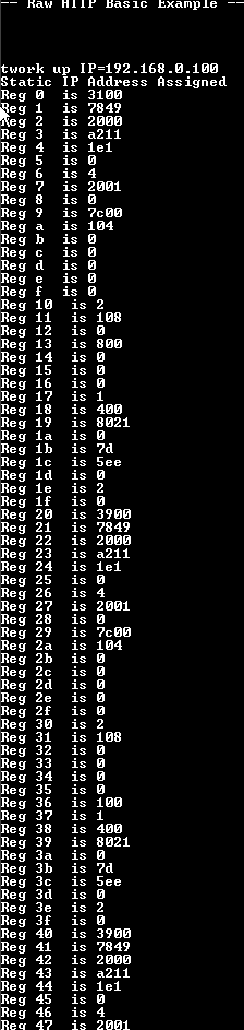

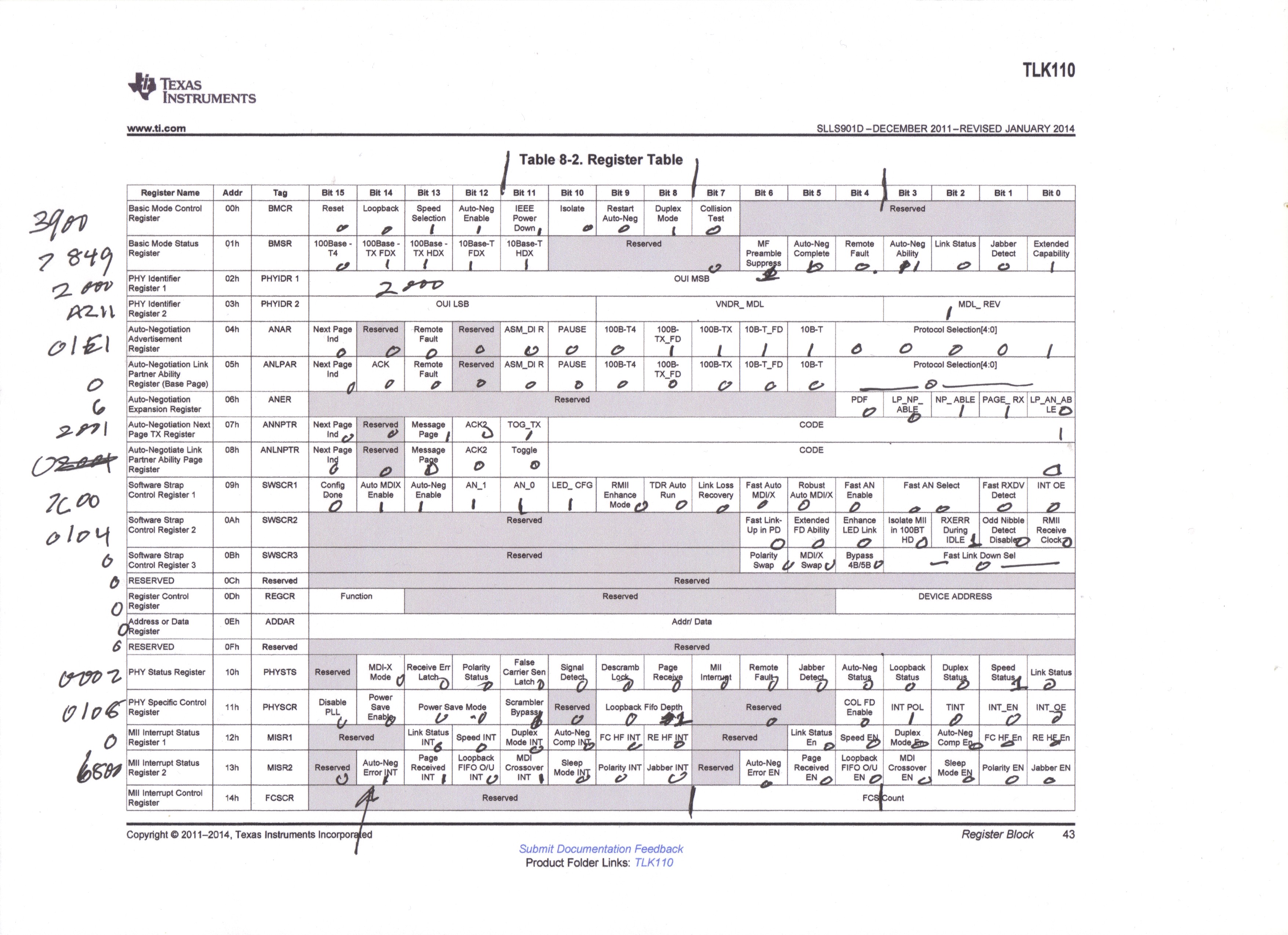

  • FINALLY GOT A GOOD REGISTER DUMP
    I found a mistake in the code to get the TLK's register dump.  (I was not enabling  gmac management.  Who knew?)
    Anyway here it is  in the attachment.  I hope you can give me some insight from this.  My take is that the receive circuitry is not working.  Is this consistent with the bias pin at 0?
  • Hi Seth,
    It looks like you read out 0x3900 for BMCR(0x0) register. Can you verify this? Bit11 is set which is IEEE power down mode. Your PHY shouldn't be doing anything at all except giving you register access. Change bit11 to 0, default BMCR should be 0x3100.

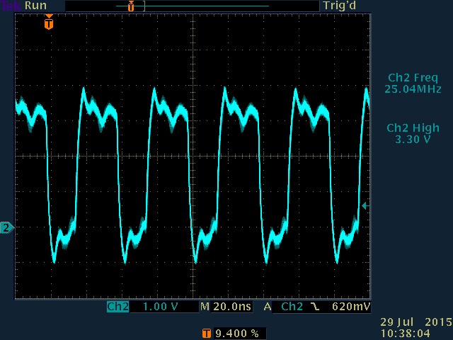

    Could you also send over scope shots of your crystal oscillating? Also are you getting tx_clk from the MAC to the PHY?

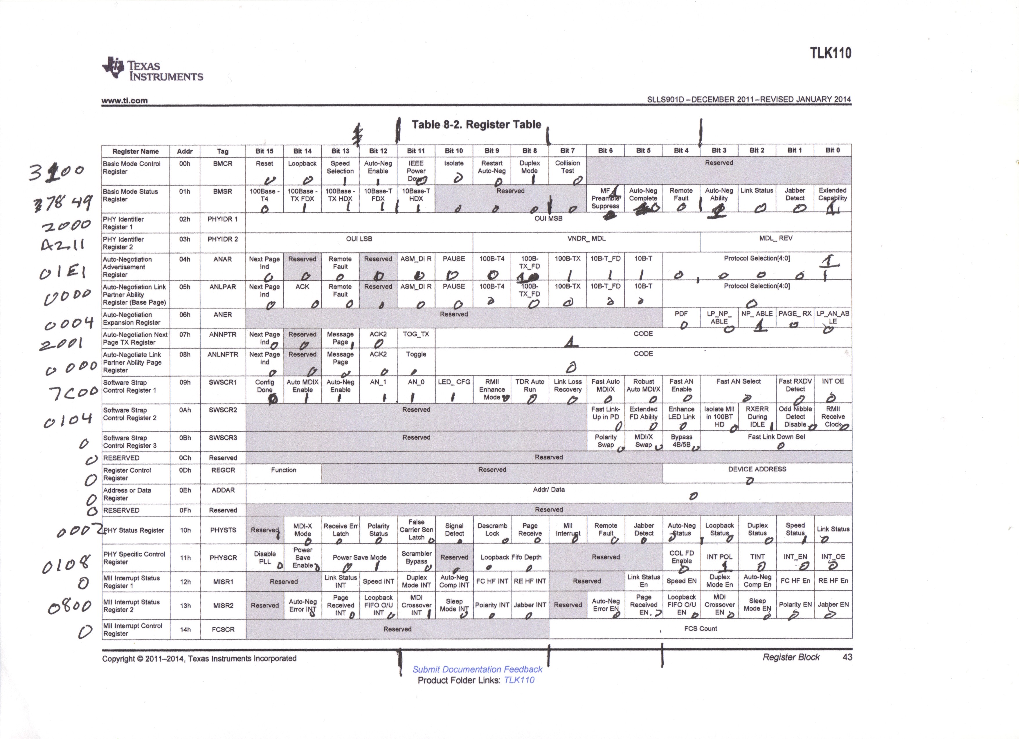

    I've made a little progress, I think.  I found that the bias resistor that connects RBIAS, pin 24, to ground was 4.87 ohms,  not 4.87 K ohms.  (It was 1000 times too small.)  For a moment, I thought that this was the problem.  Alas,no.  After replacing the resistor (with a 4.99K in parallel with 200K, It's all I have),  I found that pin 24 was now 1.24 volts as you indicated that it should be.)  But I still am not getting communication with my p.c.
    The first dump after power turned on, I had 0x3100 in the BMCR as you indicated that I should (See attached screen dump)
    Previously, the pc would indicate no connection and nothing more would happen.  Now it continually tries in that  X that used just sit there, now disappears to be replaced by the "waiting" ring, to again return to the X.
    After I tried that again, it returned to the original 0x3900 in the BMCR, but the pc bahavior continued to be different.

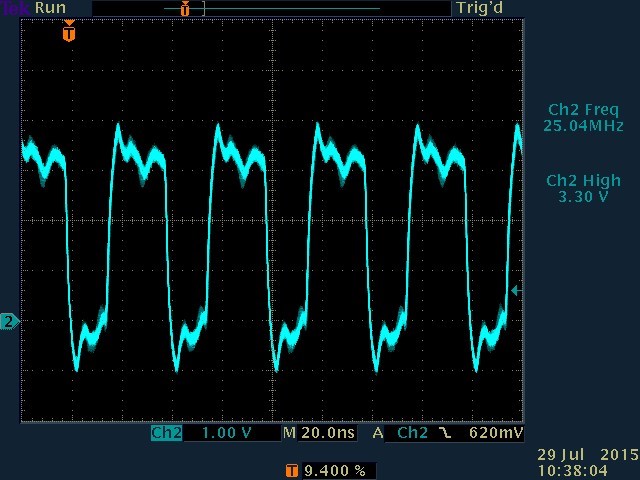

    To answer your questions.  pin 25, clock_out is shown below.  It is 25 MHz

    Some more info. It turns out that if you continually read the BMCR it reports mostly 0x3900 but there are random reads when 0x3100 is reported, about 1 in 5 times are the average, but this is variable. It looks to me like the TLK100 is negotiating successfully, but then something causes it to start a new negotiation.

    I am glad to see you are getting progress on the board. The bit that is toggling is IEEE power down which is a sleep mode defined for all 802.3 compliant PHYs. This is a strange occurence. I still believe we need to square away your clock before we can look at all the data without having doubts about validity of that data.
    Your scope is reporting the frequency is 25.04 MHz but that actually violates our PPM spec which is +/- 50 ppm. +/- 50 ppm is 25.0125 MHz.
