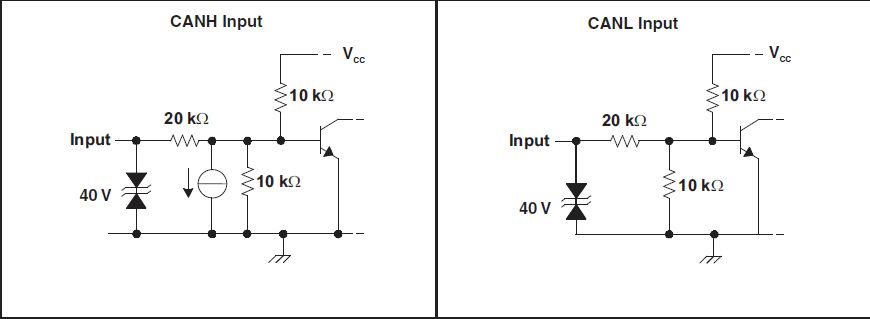

According to the datasheet of SN65HVDA1040A-Q1,
the power-off bus input current (unpowered bus leakage current), Ii(off) is 3uA (max).
However according to Figure 15. Equivalent Input and Output Schematic Diagrams,
there are 20K and 10K register on the CANL/CANH Inputs and these are connected to GND.
Is there any trick on the circuit when Vcc=0V?
