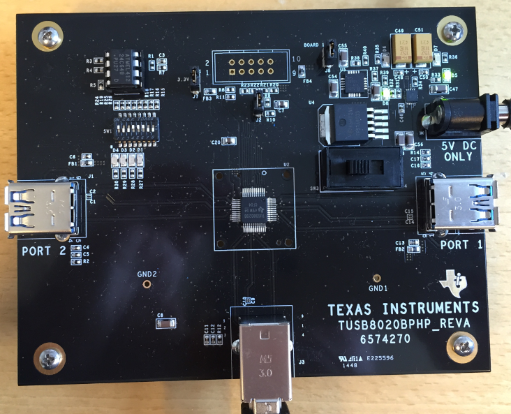

    Can you take a picture of the EVM? I want to see the setting of the DIP switches.

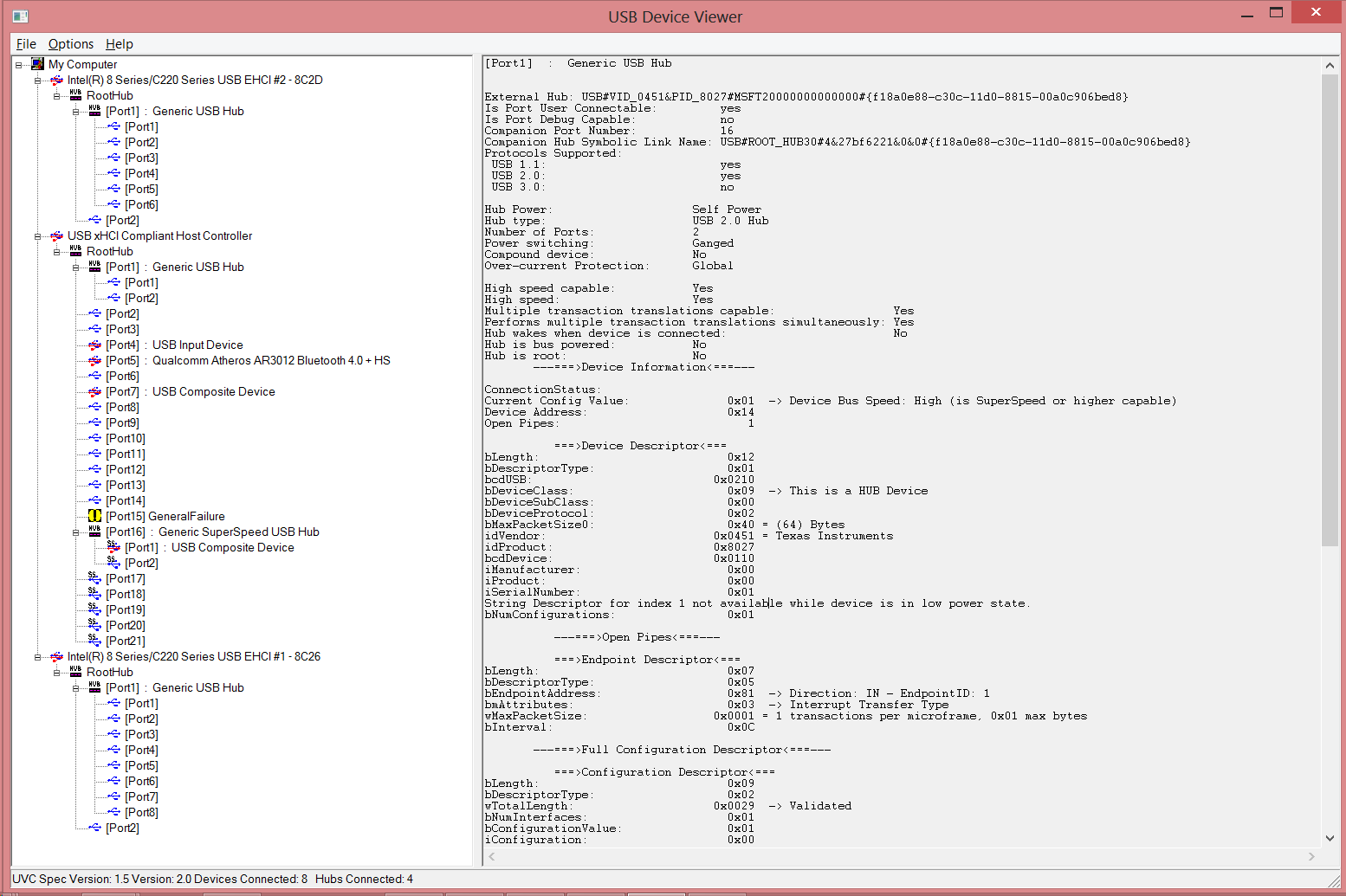

    Can you use the USBview and send a screen capture of the hub when the camera is connected? You can download the usbview from the web for free.

    1: See below for a picture of the EVM. In this case, all dip switches were set to off. I also tried to enable switches SW1_1 (FULLPWRMGMTZ_SMBA1_SS) and SW1_4 (GANGED_SMBA2_HS), but I experienced no change in behaviour.

    4: Below is a screen capture from USBView when the camera is connected:

    It looks like that is a TUSB8020B EVM, not a TUSB8040A1 EVM, so LEDs1-4 are not expected to always be lit during normal operation.
    It is hard to tell from the photo, but can you confirm if all LEDs have equal brightness? One seems dim. If so, this could mean that it has low VBUS possibly due to an EVM assembly error.

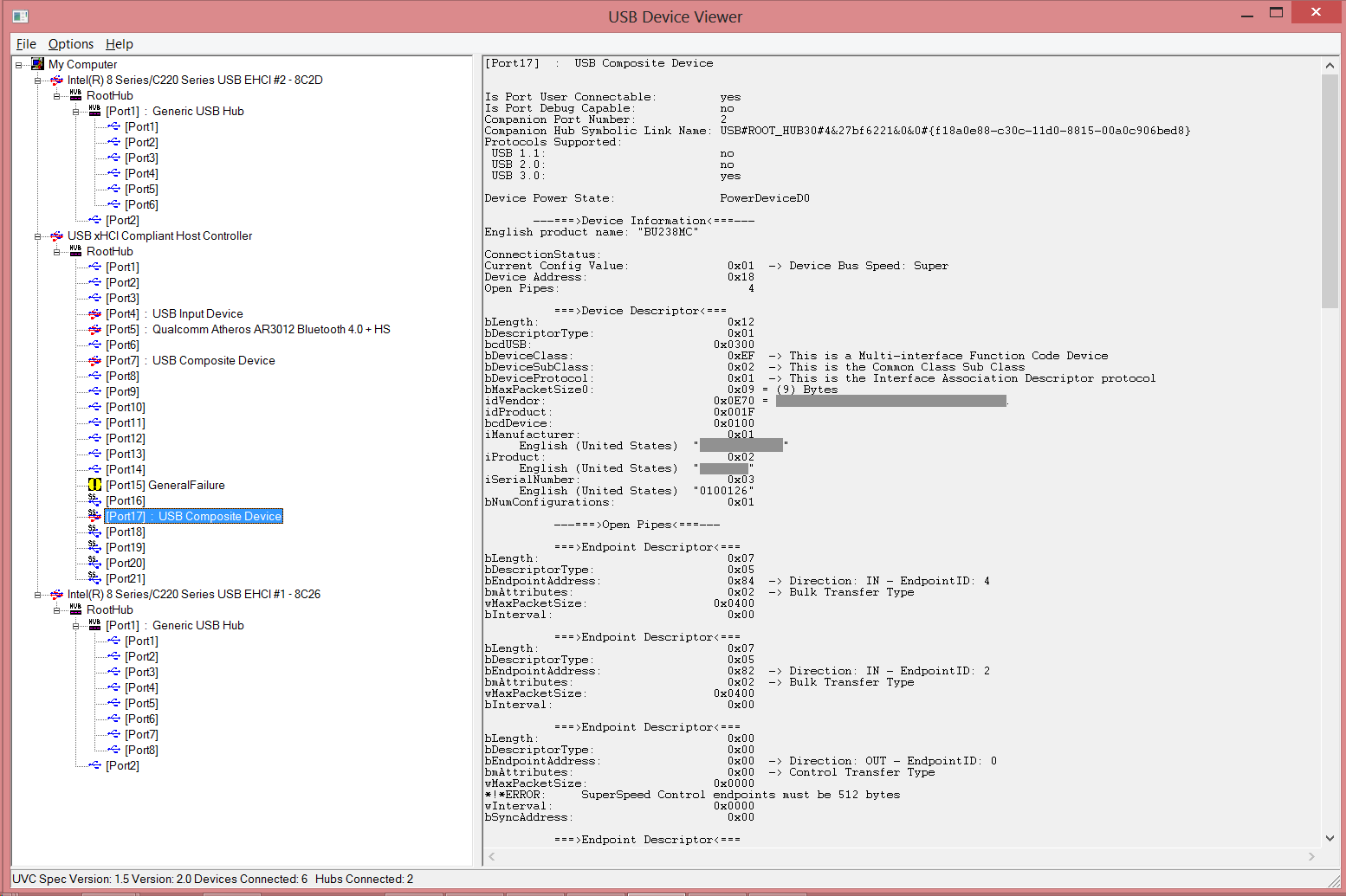

    Was that usbview screenshot from a passing or failing case? It looks like the camera connects properly but does not report the proper descriptors. If this is a failing case, I would like to see a usbview screenshot of the camera connected directly to the host controller.

    My colleague who tested it last time is on vacation now. I have therefore tested it on my PC, and I include both the failing case (camera connected via HUB) and the working case (camera connected directly to the PC).
    Working case (Note that I have greyed out the vendor, manufacturer and model - these were correctly reported)
    Failing case (via HUB)
    On my PC, it seems that the camera is not detected on the port.

    The device is loading behind the hub.  I can see the USB Composite Device entry, but it may not be accessible .  Can you provide the driver revision number for both the Renesas and Intel hosts?

    Thanks for the information.  I think the problem is related to the support of USB 3.0 intermediate power states.   If you look at the power state entry that is reported in the files you provided, when the camera is connected behind the hub it reports that it supports D2, and wake from D2, but when the camera is connected directly to the host it does not include D2 in its supported power states.  Since it appears that the host is able to read some descriptors from the camera, but not all of them, the link may be dropping into a lower power state and not waking up.
    You can download the USB LPM tool from Microsoft to see the power states on the USB bus and check if the camera is "stuck" in U2.  Or you can disable U1/U2 power states on the EVM using the EEPROM.  I've attached the EEPROM file here.  Set jumpers 5 and 6 on the EVM to access the EEPROM.

    Here is a photo of the board, where you can see that the pull-up are enabled on SDA/SCL (switches 5 and 6):
