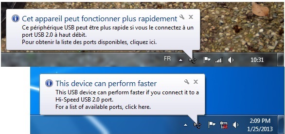

I'm making a board with the TSUB2046 in order to have a HUB USB.
You can find my schématic in PJ.
My computer recognizes the HUB, but a popup says this device can work faster. The problem is my device is recognized as a USB 1.0 (Low speed), not as a full speed.
The resistor on between DM and 3.3 is ok.
Moreover; this problem can't permit to use correctly the downstream port because I don't have so much flow on the USB. (I would like to connect a USB camera)
Have you got an idea to solve my problem?

    If the 1.5k pull-up is installed on DP it should not be recognized as a low speed device, are you sure it is marked as low speed?
    This Hub is full-speed, it is not high-speed so maybe that is why the system is telling it can perform faster.

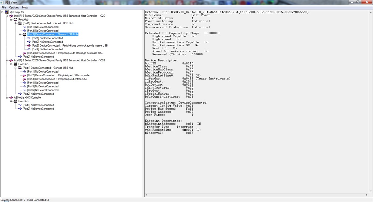

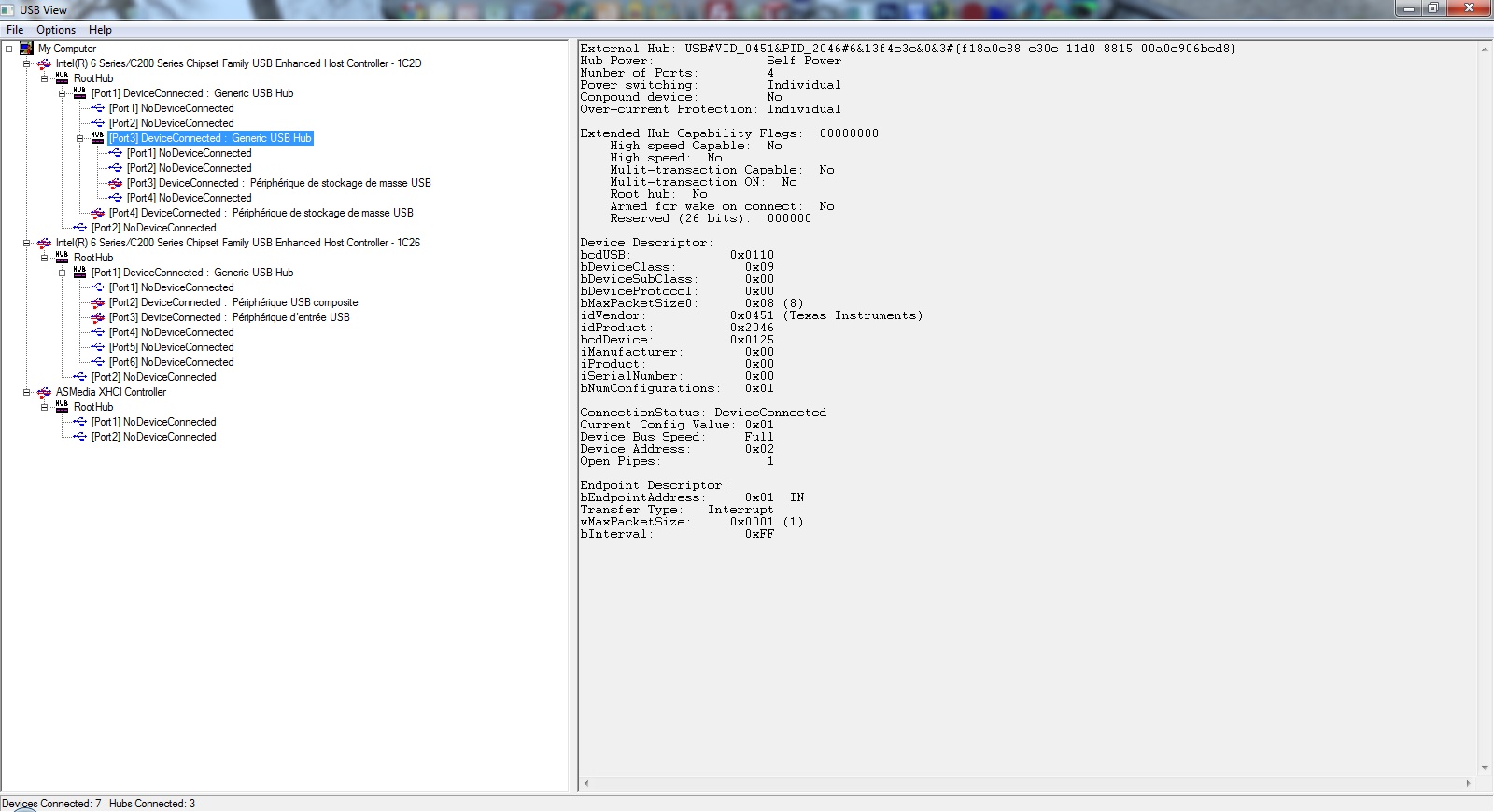

  • Execute the usbview 7411.usbview.zip utility to get more information about the hub and device. Select the item in the left window will allow its descriptors to be read in the right window. Could you attach some screen captures?
  • Dear Joel,
    You can see in the attached documents, the popup show windows when I plug the HUB USB. (in French, and English).

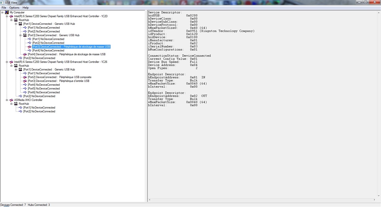

    Moreover I read all the description of the USB HUB with USBview. You can see the HUB, and the USB key connected on the HUB.
  • Even though the TUSB2046B is fully compliant with the USB 2.0 specification, the maximum speed it supports is Full-Speed. This is clearly specified on the product page within the Features section "Fully Compliant With the USB Specification as a Full-Speed Hub"
    However, the USB 2.0 specification defines 3 different speed connections: Low Speed, Full Speed and High Speed.
    So it is expected that connecting USB thumb drive that can support USB 2.0 HIGH speed, will prompt you with a message indicating your device can perform faster. Because you are connecting a HIGH speed device to a FULL speed Hub.
    On the screenshots you provided from USBview I can see the TUSB2046B is properly connected at full speed, so there is nothing wrong going on. (See "Device Bus Speed : Full")

    When i plug it to a computer, it's recognize. When I plug a USB key, usb/RS232 converter, all device works fine.

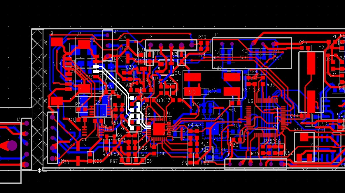

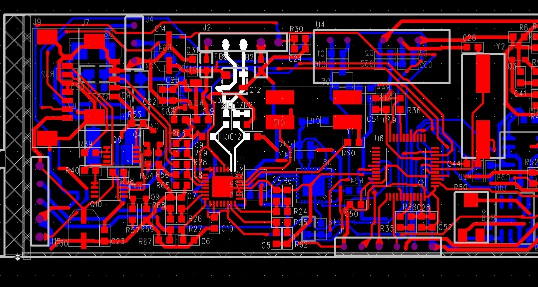

    upstream ports: D+/D-:
    Downstream port for camera:
    It seems that your Differential Signal Traces do not meet the routing requirements. We need your PCB file for further analysis, please send it to joel.jimenez@ti.com.
    Please, take a look at these documents below, they contain more details on the High-Speed Differential Signal Routing.
