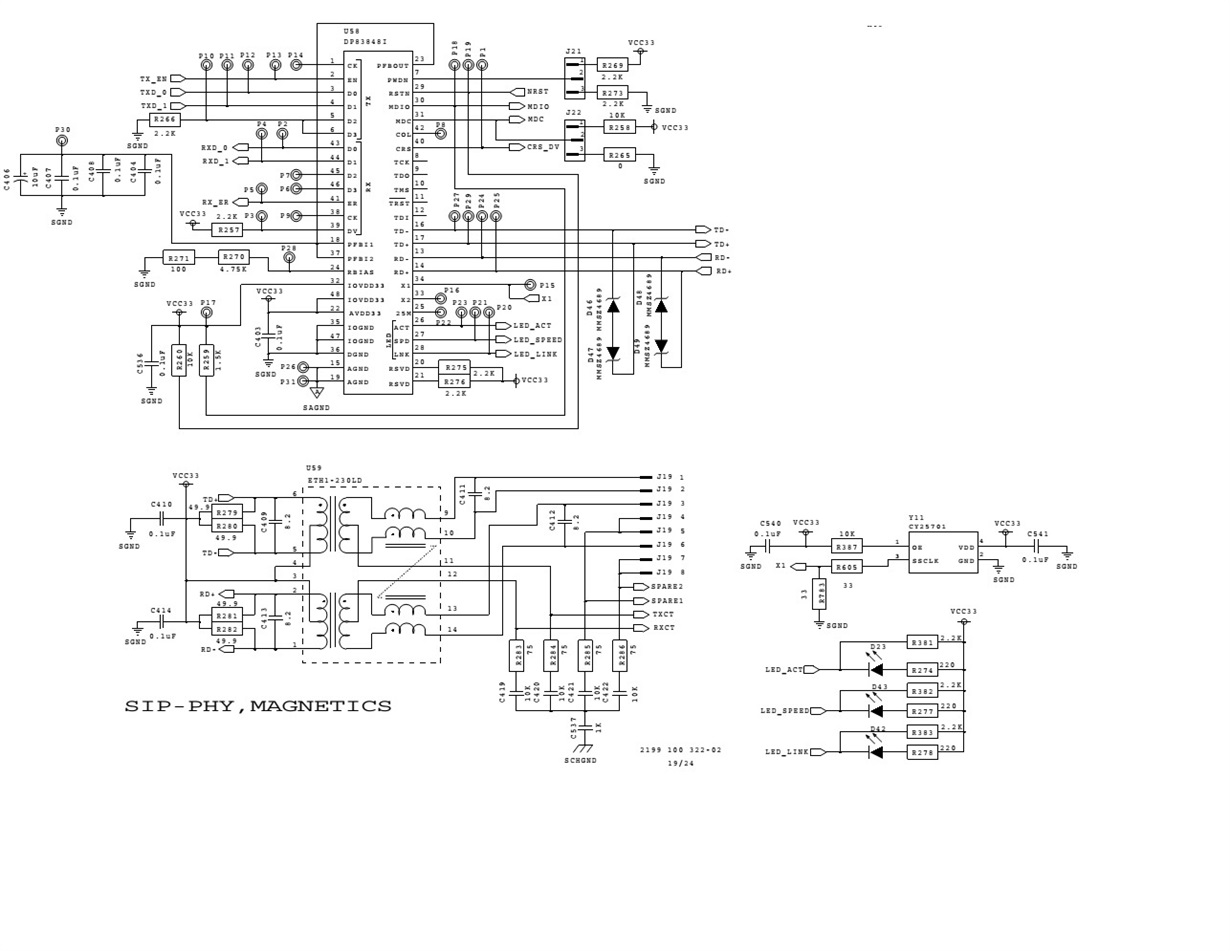

We are using DP83848I PHY please find the attached SD, when the phy is powered on firts time

    The schematic provided looks pretty good. I have only a few minor notes. The capacitors across the transmit and receive pairs of the PHY are not necessary and could actually have a negative impact on the signal quality of those signals. I would recommend removing these.
    The decoupling for the PFB pins looks good, but there does not appear to be sufficient supply decoupling on the IOVDD33 and AVDD33 supplies. Are there other decoupling capacitors for these pins in the design that are not shown in the portion of the schematic that was provided?

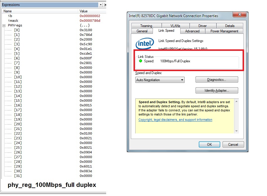

  • Dear Sir,
    Patrik and Rob Rodrigues thankyou for the quick reply.  The PC shows that the PHY is negotiated to 100M half duplex. In
    this state PC should have pinged the board. But this is not happening. The PC receives packets(saw in wireshark) but the board
    is not receiving packet(saw via ifconfig command).
    I will remove the capacitors between the TX and RX pairs.
    Only those are the decoupling  capacitors on the IOVDD33 and AVDD33 supplies. What values and how many decaps should
    I put...?
    What voltage should I get on RBIAS pin ? When I measured the resistance on the board it measures to be less than 4.6K.  So I tried to
    increase the resistance value to match to 4.87K. But it dint improve the situation.

  • Dear Sir,
    I'm able to read the registers. I have attached the register dump when the PHY is in 100Mbs full and half duplex.
