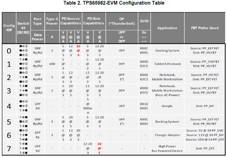

He set ID#6 for provider and ID#7 for consumer, then connect these EVMs with typeC cable.

    - Provider (ID#6):TPS65982EVM (rev.D, 9.00)
    - Consumer (ID#7):TPS65982EVM (rev.C, 8.07)

    CC1 on Board A (Provider, ID#6) should be pulled up to 3.3V to indicate it has an Rp pull-up current source.
    CC1 on Board B (Consumer, ID#7) should be pulled down to GND to indicate it has an Rd pull-down resistor.
    When you connect the 2 boards, CC1 should go to a mid-rail voltage (~1.67V) and PD communication should be superimposed on the DC voltage.
