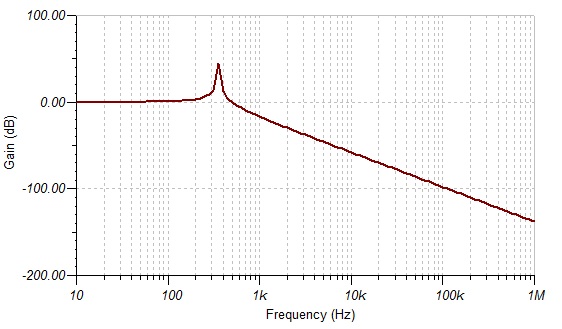

  • Hello Murat,
    did I get you right, you want to generate the 5V for your slave card from 24V with an LDO transmitted over the bus lines?
    If so the LDO will help you to filter the signal as well, but please take into account that dependent on your current consumption you might dissipate a lot of heat there.
    Regarding the filter we have a low pass transfer function from bus line to power line. Dependent on the values you choose for L and C it looks similar to the following plot:
    To calculate appropriate values for L and C you should know:
    1. The maximum ripple allowed after the filter. This might be related to the LDO you plan to use, the input capacitor of the LDO, etc.
    2. The frequencies you want to attenuate. I am not familiar with the Modbus protocol, but you should know the lowest frequency you need to "block". An easy way might be to do a fourier analysis of your signal with an oscilloscope and check the higher energy frequencies contained. The "main" frequency in your case should be 9.6 kHz for a baud rate of 4.8 kbaud, but with  series of ones and zeros you will get other frequencies as well (and it is no sine of course, but those harmonics will be of higher frequency).
    You can calculate the -3dB roll-off frequency using the following formula:
    Also be aware of the current rating of your inductors, those will conduct all your current to your slave boards.
