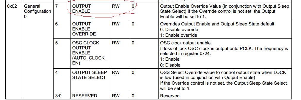

Can DS90UH948-Q1 work without IIC control?
Also, what's the default value of OUTPUT ENABLE BIT?
Thank you very much!
  • Hi Jason,
    The default value of 0x02[7]=0 but not applicable if 0x02[6] is not set. The device’s outputs are enabled by default via pin straps.
