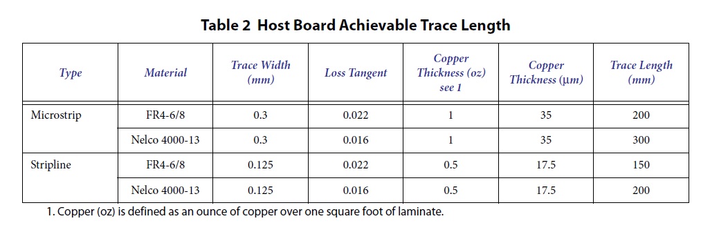

Hi.
Is any requirement for minimum or recommendation
for optimal trace length for SFI interface.
TLK10232 to SFP+ for example.

According to the SFF-8431 standard the SFI Typical PCB Reach:
The SFI channel may be implemented with either microstrip or stripline strfictures. Exmaple host boards designs with typical PCB reaches are shown in the next table:
