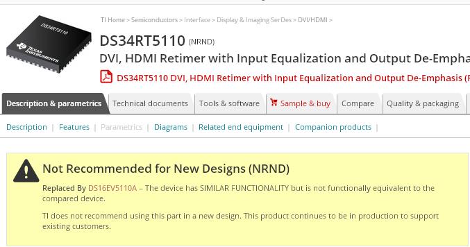

Hi
I am looking for HDMI v1.4 re-shape/ repeater for tablet.
Please let me know your advice for correct selection.
BR
Lewis
Hi Lewis,
You can use DS34RT5110 for HDMI 1.4 as equalizer ONLY. This is why i had provided the link to the equalizer only report. The only difference between DS16EV5110 and DS34RT5110 in equalizer only mode is the data rates. One supporting 2.25 Gbps while DS34 supporting 3.4 Gbps.
If this application requires HDMI retiming and equalization, please consider using SN65DP159.
Regards,,nasser
