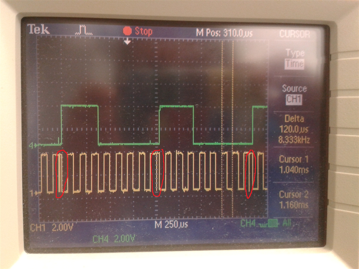

  • Hallo ,
    Thank you.
    In my case VCC = 3.3 V
    I attach the osci snapshot.
    Master  sends 0xE0 (Write). Is the resolution OK? Tank you!
  • Thanks for the scope shot. It does not contain the start bit so i do not know where the data starts, but I see something of greater concern, which I believe the issue is caused by.
    You have small pulses on the clock line which are getting interpreted as an extra clock pulse. I am fairly sure that these glitches make the TCA device latch in an extra bit, which is making it see the incorrect address. Please see the parts circled in red in the scope shot below:
    This is a result of your I2C master. You need to figure out the cause of these glitches and get rid of them. The I2C spec mandates that all I2C devices have an internal  deglitch filter of 2us to prevent false triggers like this. But your glitches appear to be much much longer than 2us to show up on this time scale, which is why the slave device interprets it as another clock rising edge.
