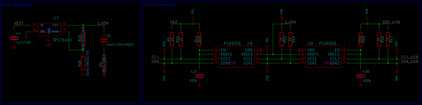

I need to connect an I2C master device biased at 3.3 V to an I2C slave device that can be biased from 2.3 to 5.5 V.
1.- Is it any level translator that I can use? I only found level translators that require that one of the reference voltage is always bigger that the other.
2.- If there is no simple chip to do that, Is it possible to use some thing like this (VDD ranges from 2.3 to 5.5 V)?
Thank you in advance
