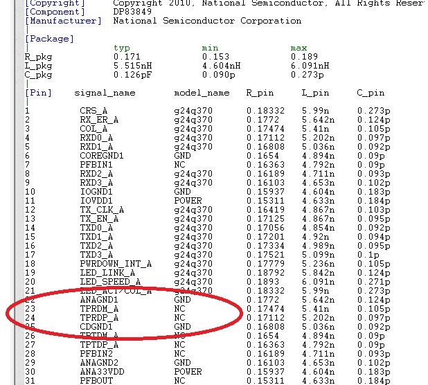

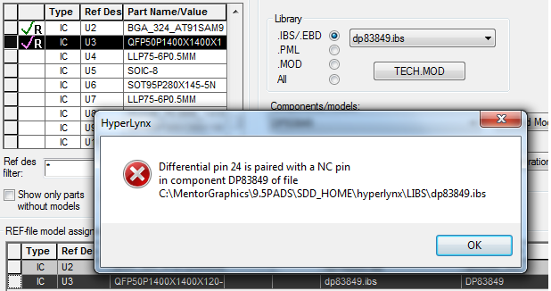

I have downloaded IBIS Model of DP83849I from www.ti.com/.../toolssoftware.
When I assign the Model I get the following Error:
"Differential Pin 24 is paired with a NC pin in component DP83849" and I am unable to assign the model.
Kindly suggest the solution.
