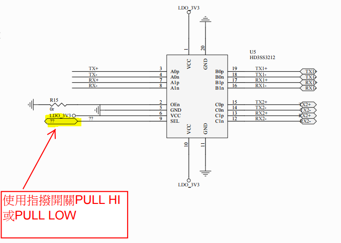

Hi there,
Wish one of you can help below issue. Thanks.
The Macbook connects with USB-C Digital AV Multiport Adapter firstly, and then USB-C Digital AV Multiport Adapter connects with the PC board built-in TPS65982.
Everything goes well on detecting USB 3.0 signal (R/W speed: over 60 Mbps). But it is odd when the Macbook connects with the PC board built-in TPS65982 directly, it can only detect USB 2.0 signal (R/W speed: under 60 Mbps)
You may check the test thru below link.
Where is the problem?
The USB SS Mux has built the HD3SS3212 IC.  Would it be better to build USB3.0 Redriver IC on PC board beforeHD3SS3212 to improve the USB 3.0 signal?
Note:
Your Firmware version:  TPS65982-EVM_Flash-Image_RTM.BIN
Type C connector is checked ok no matter up or down.  HD3SS3212 is manually opened.
