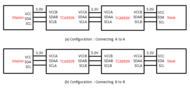

Could you please tell us whether TCA9509s can be connected in series ?
Is it possible to adopt as the following configurations if possible ?

So, could you please give me your advice regarding the device and the configuration which you recommend since we would need that the VOL for the master and slave side is less than 0.4V ?

As you said, our customer requests that the master and slave are both at 5V.
I will suggest whether TCA9509 is able to be used in scenario B(Connecting B to B with TCA9509s) to our customer.
