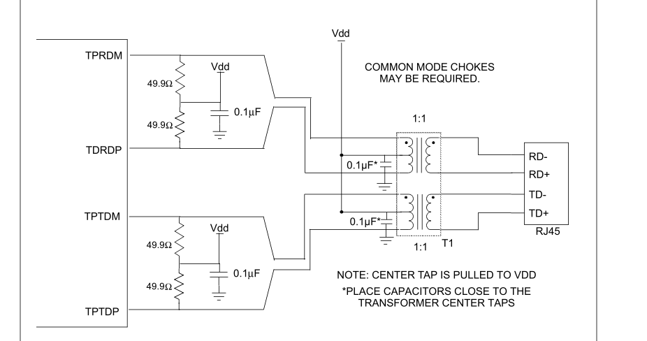

  • Dear Sirs
    The datasheet of dp83849 suggest RJ45 Transformer TCT and RCT Pull high resistor.
    But I do not set Transformer RCT and TCT pull high resistor, it still work.
    Does the Transformer RCT and TCT pull-high resistor necessary?

  • Nat,
    Both transformer center taps should be connected to 3.3V and de-coupled to ground using 0.1uF capacitors.  Each of the transmit and receive pins that connect to the transformer should have a 50 Ohm termination resistor to the 3.3V supply.  These connections are required due to the fact that the DP83849 has a current mode line driver.

  • Dear Patrick
    Why should transformer center taps be connected to 3.3V?

  • Nat,
    Connecting the transformer center tap to the supply is intended to provide a better common mode point for the transformer. This connection generally provides better performance.

  • Dear Patrick
    If I do NOT connect the transformer center tap to the supply,
    do you have any comment?

  • The circuit will still operate if the transformer center tap is not connected to the supply. I would still recommend that you connect the center tap to the supply if possible. If this connection is not possible, you should validate your application carefully to make sure it meets the needs of your system with this connection.
