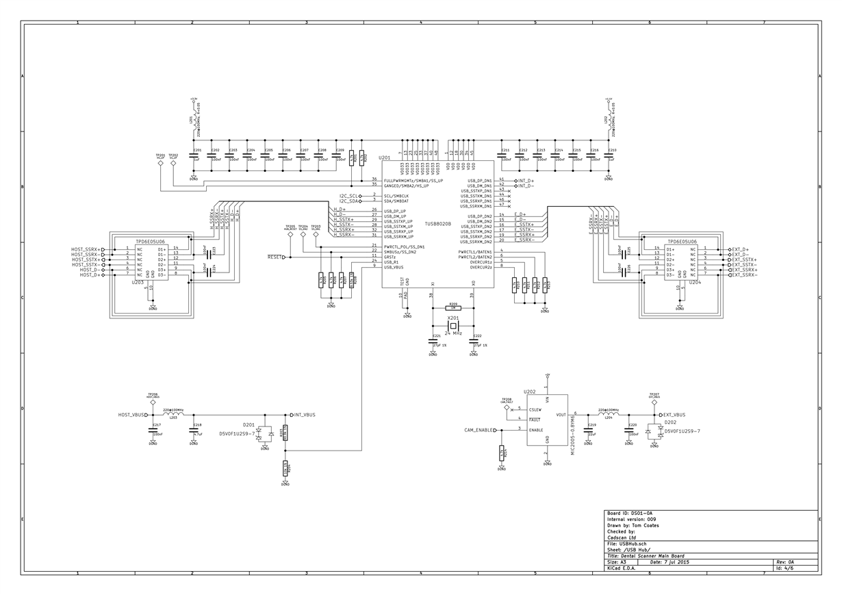

I have developed a board using a TUSB8020B USB hub. One port is routed via a type A connector to an off-the-shelf USB3 camera module, the other port connects via USB2 only to an on-board microcontroller. This microcontroller also connects to the hub via SMBUS for configuration. Right now for debugging I'm just using the default register values the chip starts up with. The only change I'm making is writing 0x01 to the Device Status and Command Register (address 0xF8) to set the cfgActive bit and enable the hub. However, I'm unable to connect to any devices plugged into the hub.
When I open device manager, there is a yellow warning triangle next to the USB hub icon for the device. When I right click on the device and select properties, the Device Status says:
> Windows has stopped this device because it has reported problems. (Code 43)
> The USB hub failed to reset.
Looking on Microsoft's website, code 43 seems like a generic error message about a driver or hardware problem: https://technet.microsoft.com/en-gb/library/cc725873(v=ws.10).aspx. Their suggested solution (uninstalling and reinstalling the device) didn't help. I tried using Microsoft's USB Hardware Verifier (part of the MUTT package: https://msdn.microsoft.com/en-us/library/windows/hardware/dn376875(v=vs.85).aspx

At first glance it looks like the PC can't communicate with the hub properly, but it's clearly recognising that it is a hub, and looking in device manager I can see that it's picked up the vendor/product IDs properly, so it must be able to communicate OK.

Any ideas?
  • Hi Tom,
    What's the status of USB_VBUS to the hub?  Can you post a schematic (just the hub and upstream connector is needed)?
    Try downloading the usbview.exe utility from Microsoft and to determine if the resets are occurring on the USB 2.0 side of the hub or the USB 3.0 side - you should see a separate entry on the tree for each.  Also, try disabling U1U2 in Register 05h, the camera module may have a power state issue.
    JMMN
  •  USB_VBUS pin measures 0.5V after the divider, as expected. If you need a full schematic I can PM it to you, but I don't want to post it publically for obvious reasons.
    Had another look at it today and found that the hub connects ok when plugged into a USB2 port, but fails when plugged into a USB3 port. I still can't get any devices to connect to it though (USB2 or 3). I've verified continuity on the USB pins from hub to connector with a multimeter and can't see any issues there.
    I'm beginning to expect impedance control issues, but unfortunately I don't have the equipment to actually test that. I'll have to see what I can beg/borrow/steal. Will update when I have more information.
  • Hi Tom,
    Take pulldowns off OVERCUR (R210 and R211), those inputs are active low and the hub will report overcurrent events to the host. The host may stop accessing the hub at that point.
    Make sure the hub is getting an adequate reset, the pulldown on GRSTz may cause problems.
    You can also remove the pulldowns on the PWRCTL lines. They wont affect the hub operation but you'll get an increase in power consumption with them since the PWRCTL outputs will be driving a load.
    If the problem with USB 3.0 operation persists disable U1U2 in register 0x5h.
    JMMN
