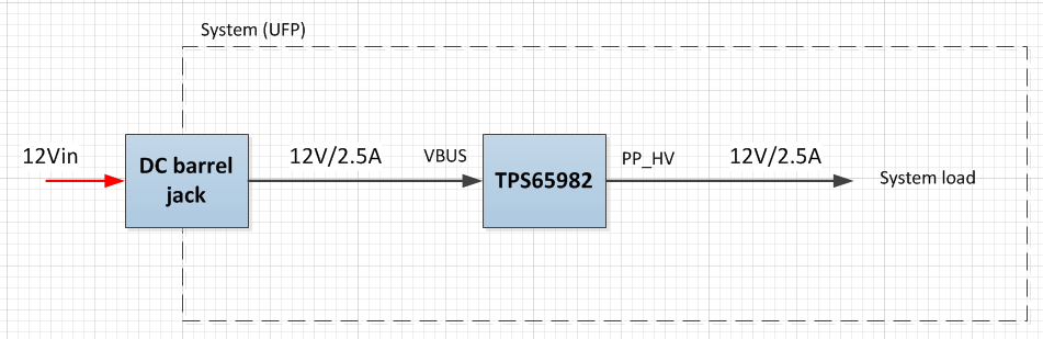

For TPS65982 in UFP role, is it possible to pass a non-PD source (12V DC barrel jack), either through the internal power path (PP_HV) or the external FET (PP_EXT)?
On the TPS65982-EVM, "Configuration ID 3: Notebook (or Mobile Workstation) That can Pass AC-Adapted Power" seems to describe this use case, but I'm not sure if I'm understanding it correctly. If there's no PD DFP, will ID 3 pass the barrel jack 12V to VBUS?
Jonathan

  • Hi Brian,

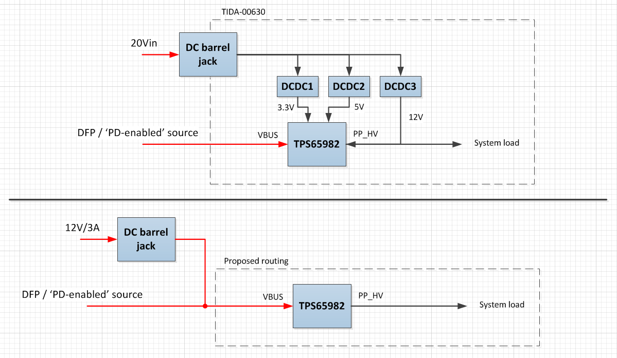

    Thanks for the quick reply. I may have worded it poorly, so hopefully this block is more clear:
    I want TPS65982 to sink the 12V from the barrel jack, to supply to the system.
    Sometimes I'll have a proper USB Type C DFP-enabled charger instead of the 12V barrel jack, so in those cases it will negotiate with TPS65982. But I'd like to be able to pass this DC barrel jack power if a Type C charger is not available.
    Let me know if this is still an acceptable use case,
    EDIT: I had flipped PP_HV and VBUS in my original block, so I fixed it w.r.t. the proper direction for the sink case.
    Jonathan

  • Hi Karl,
    Thanks for the reply. I think I see where the confusion lies now, after going through the TIDA-00630 schematic.
    On TIDA-00630, the DC barrel jack provides power directly to three DC/DCs, one of which (12Vout) is tied directly to the HV_Source net (PP_HV), completely bypassing TPS65982.
    In my use case, I wanted the DC barrel jack to be connected to the VBUS net, and for TPS65982 to let it pass through the internal power path, enjoying the current limiting and other features a PD-negotiated source would have.
    However, in the dead battery case, 5V and 3.3V would need to be generated by the external power source via DC/DCs, which adds complication, size, and cost. In the end, I think implementing something closer to the TIDA-00630 topology is the best solution, even though I don't need source capabilities.
    Let me know if what I said above makes sense and you agree with my analysis / conclusion.
    Jonathan
  • Just wanted to close this thread off - after discussing offline, the DC barrel jack cannot be applied directly to VBUS, as this is a violation of the USB spec. To have a HV source passed through VBUS, it must be negotiated by a proper DFP first.
    Jonathan
