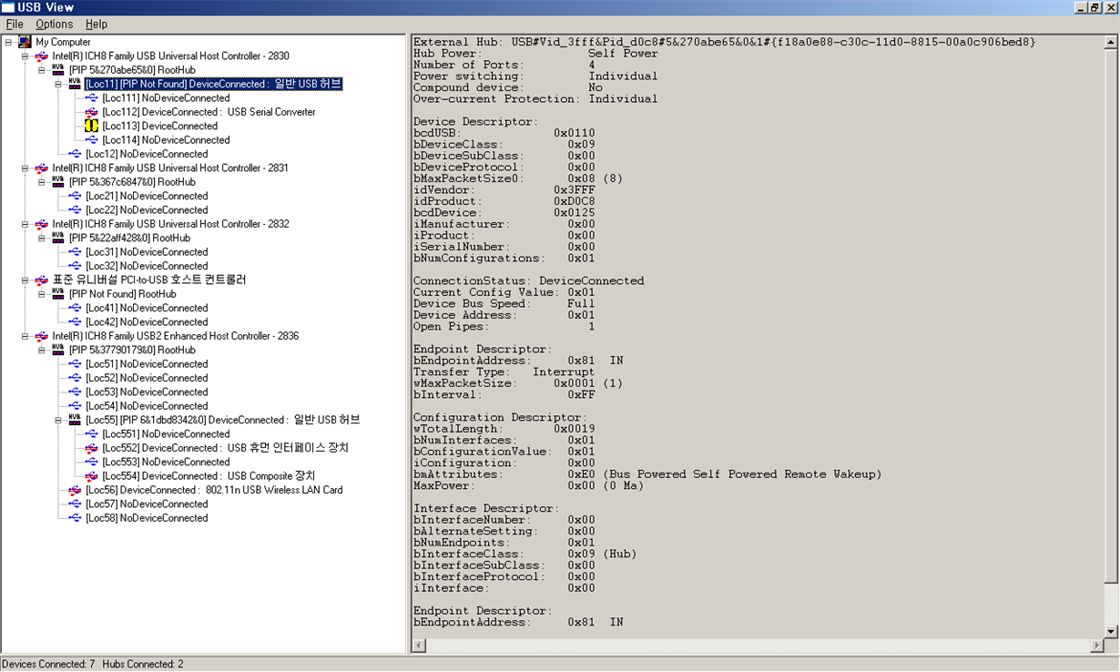

We know the TUSB2046B can interface external EEPROM using pin configuration.

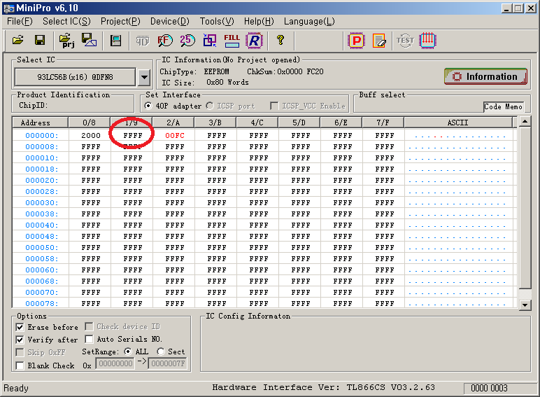

We has been refered datasheet of the VID high-byte and VID low-byte and PID high-byte and PID-low byte configuration on external EEPROM.

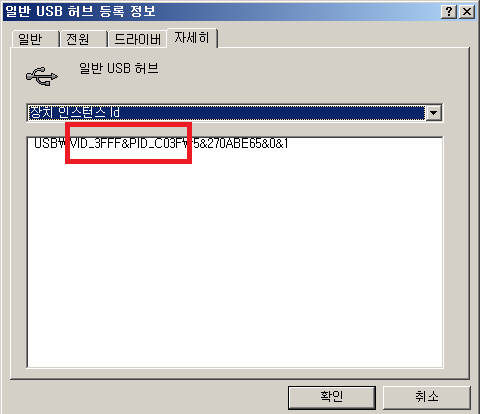

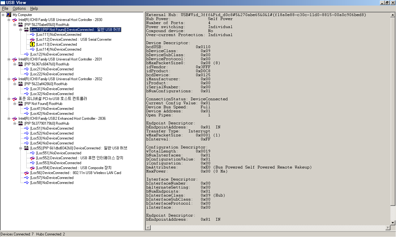

But, Now we write EEPROM of VID 0xFFFFh, windows device manager appear that information 0x3FFFh.
What is this problem? How can we read Windows Device Manager device attribute on 0xFFFFh?
