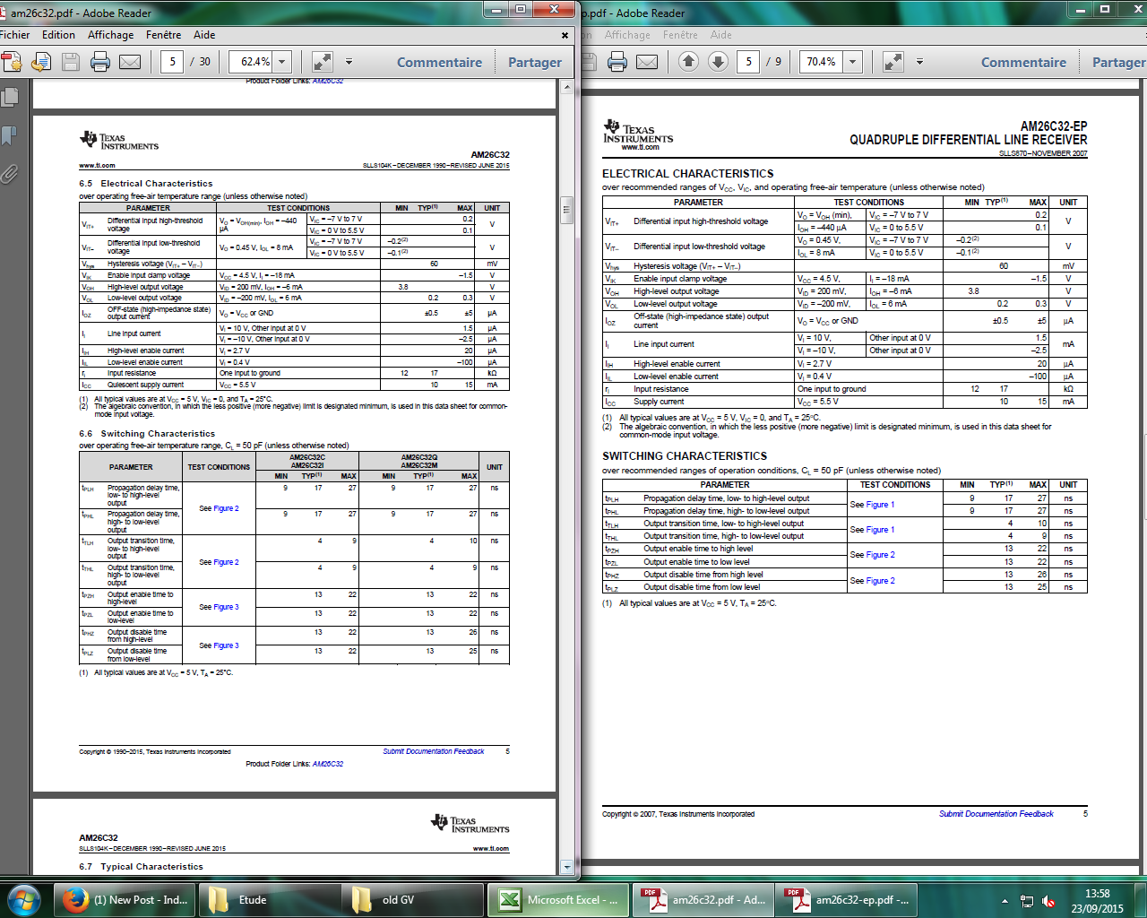

I'm using the AM26C32 component.
In the datasheet No SLLS104K from DECEMBER 1990, REVISED JUNE 2015, I found strange values in section 6.5 "Electrical Characteristics" (p5). In this table, the specification for the "Line input current" (Ii) is 1.5�A (or -2.5�A). In the older datasheet No SLLS870 from NOVEMBER 2007, the maximum specification for this same "Input line current" was 1.5mA (or -2.5mA).]
I need a written confirmation that there is a mistake on the latest revision
