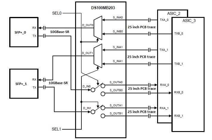

I would like to know whether DS100MB203 supports 10GBase-SR?
The application that i am looking forward to implement is shown below. Please let me know whether this is a feasible solution? or please suggest a alternate solution.

Jijesh,
The DS100MB203 can work with 10GbE SR. I am worried that it will be difficult to meet SFP+ eye mask requirements after 25 inches of FR4. I am assuming at least a couple connectors will also be in the channel.
