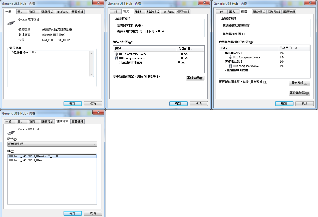

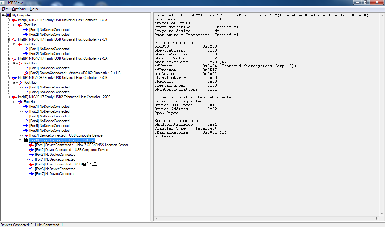

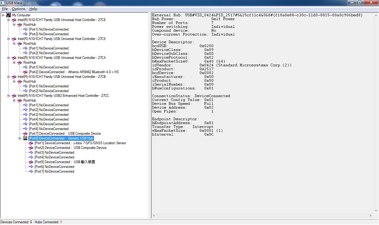

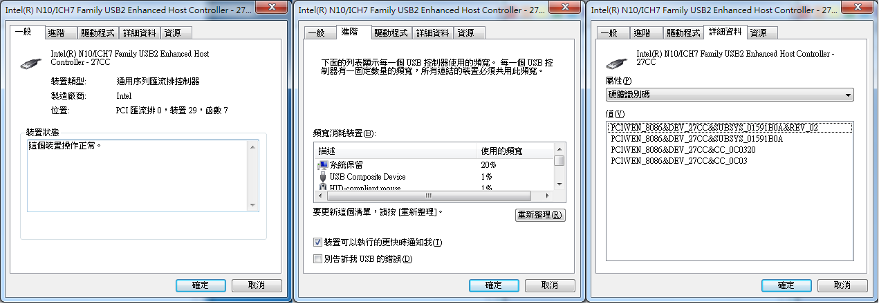

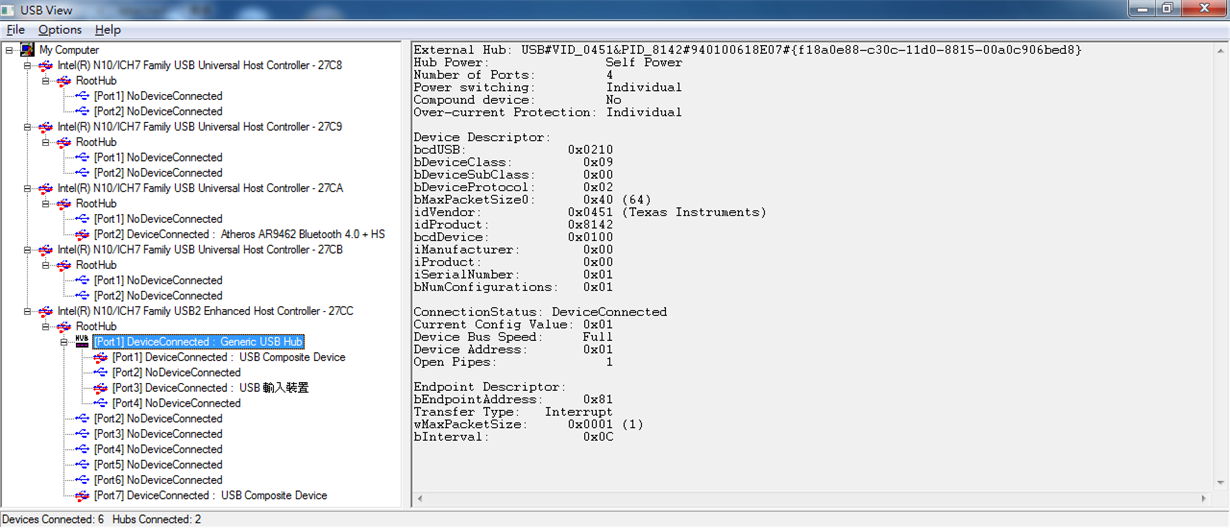

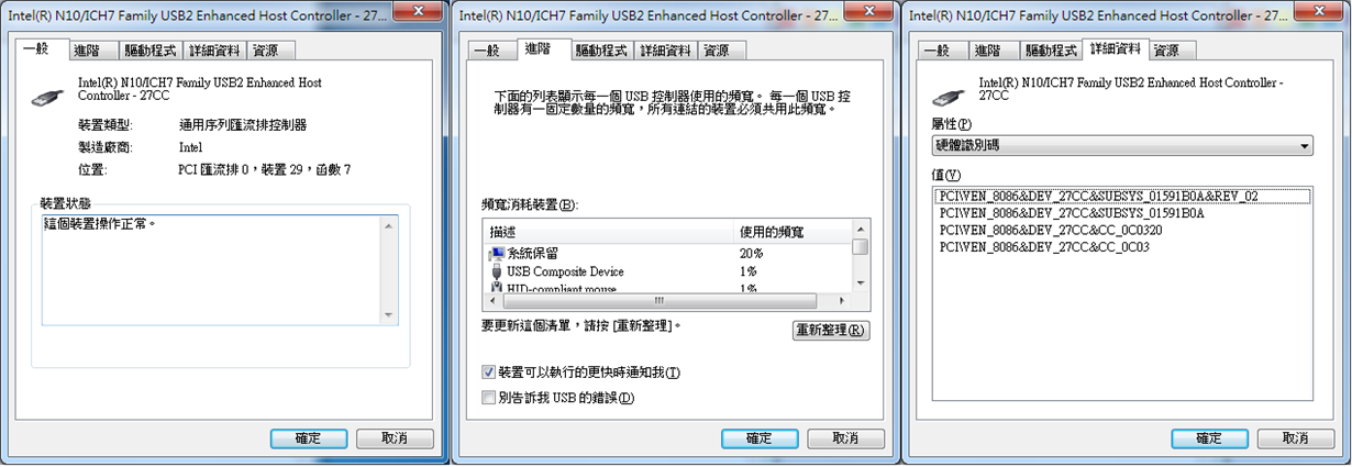

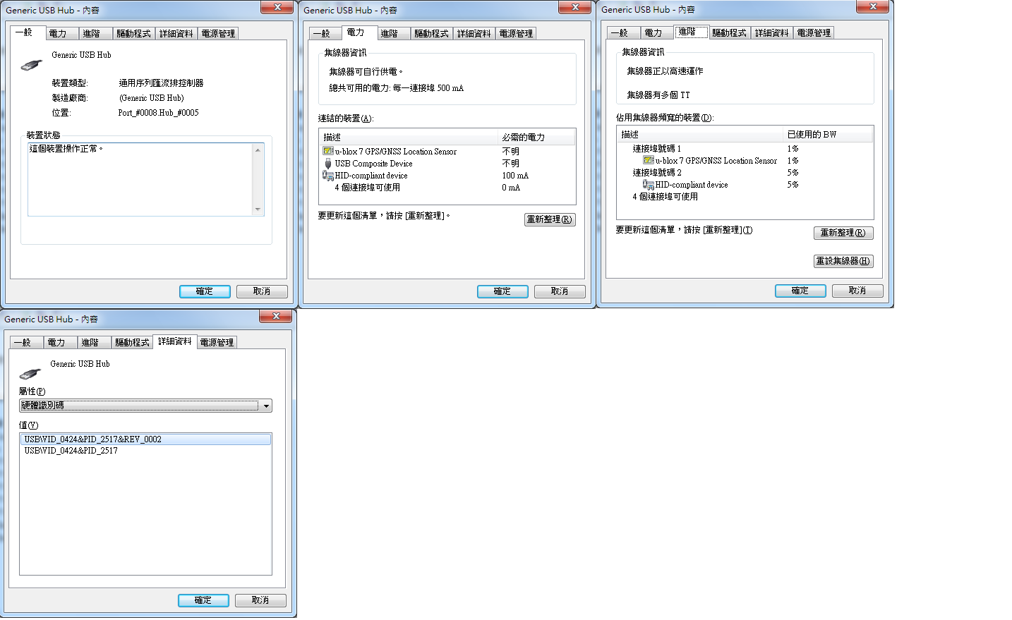

  • Hello Juhnny,
    Can you download the usbview.exe utility from Microsoft and send a screen capture of what the USB tree looks like when the hub is attached?  Can you also send a screen capture of the device manager status?
    JMMN
  • unattached usb hub as above
    attached hub as above
  • Which devices are disappearing after the hub is attached? Can you try removing the devices downstream of the TUSB8041 (the devices attached to the TUSB8041) as a test? If there are driver issues with those devices, the rest of the USB tree will not enumerate. From the screen captures you provided, all the USB hub drivers and connections appear to be correct.
