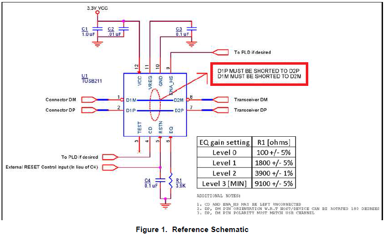

TUSB211 / D1x must be shorted to D2x
Guru 29720 points
Other Parts Discussed in Thread: TUSB211
Hi Team,
The reference schematic shows "D1x must be shorted to D2x" as the following but my customer concern if it could be a redriver function.
May I have your comment?
In addition, is the above reference schematic the same as TUSB211EVM?
